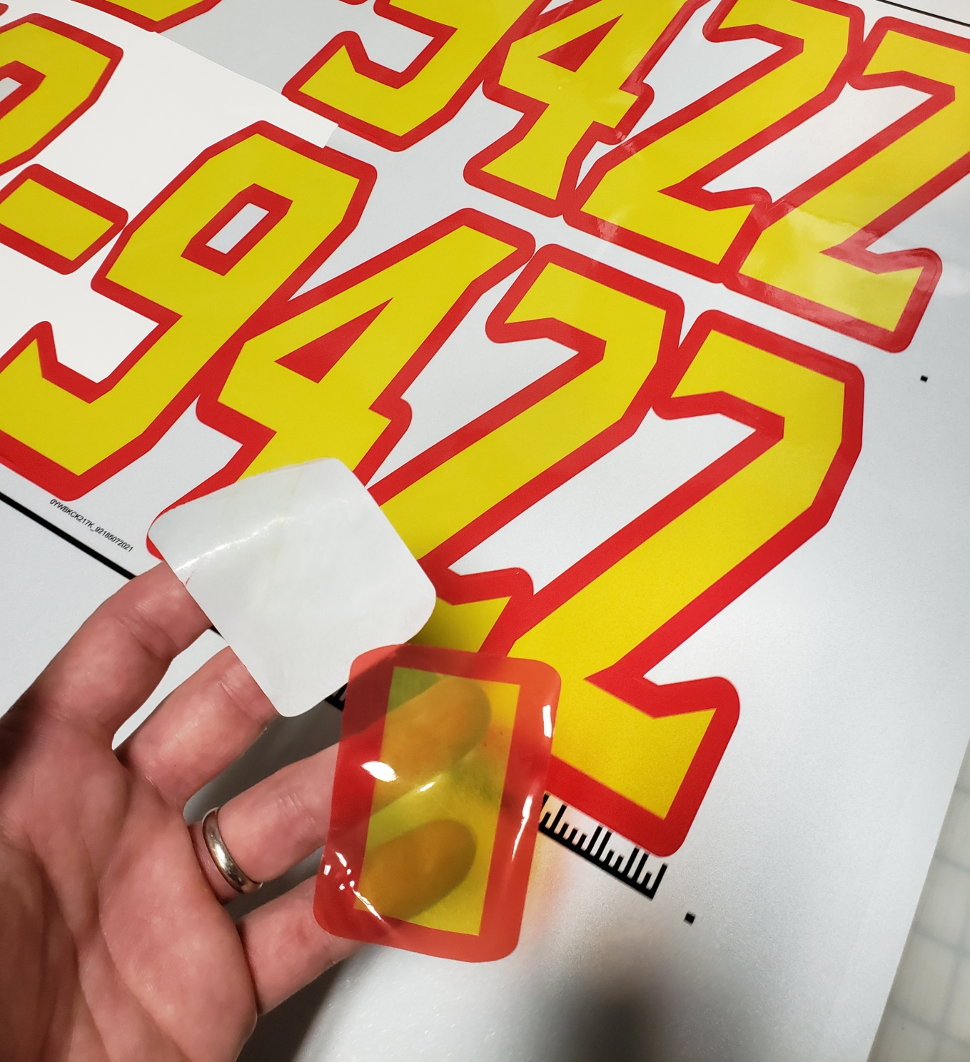

Something crazy happened yesterday. Latex ink on Reflective vinyl... came up with the laminate (completely separated) on a piece weeded out... I've NEVER seen this before. Looks like a Print on clear vinyl....but I promise it's not.
