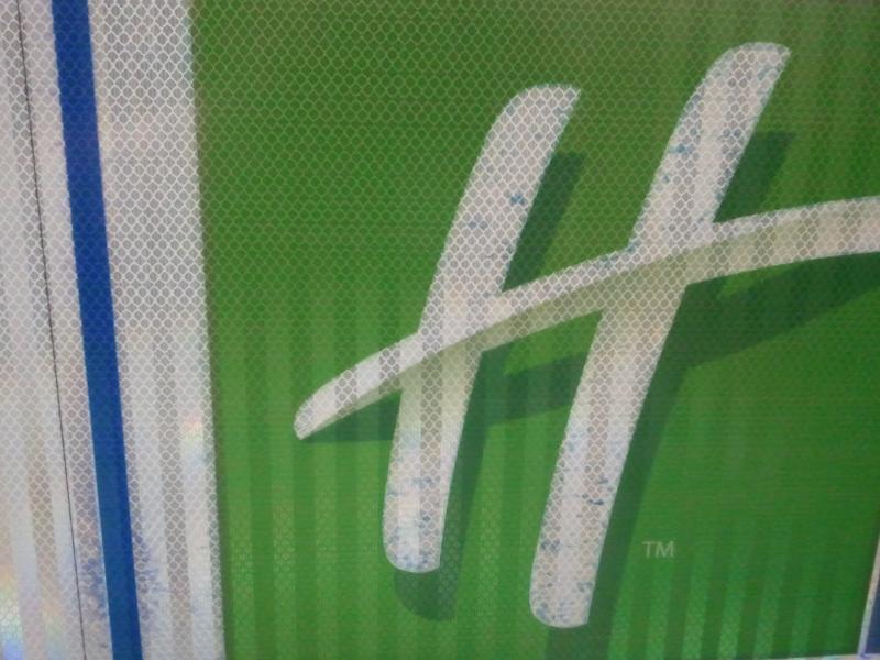

Have you looked at one at nighttime with headlights ??
Place that sample you posted on a stick in a dimly lit alley. Drive up the alley and see if you can read it.
If you can, you half of the battle won.

I'd say you got three options:
1. Keep doing what you're doing. (Doesn't meet specs and you can't print it.)
2. Print it on clear, laminate it and apply that to the HI. (Doesn't meet specs but you should have no problem printing it.)
3. Outsource to a company that does this type of work (Will meet specs. and you can start printing something else.)
Good luck!

I don't think it should be a sticky, everyone that I have had to advise on, that tried to digital print actual MUTCD compliant traffic signs on retroreflective has failed to make a compliant, colorfast sign. Most shops that do this are specialty shops, they usually have direct contact with a 3M rep who can guide them with their options or with any new technology. Designers who specialize in the design of it go through that route too. If you are experimenting, then your going to find yourself in a long line of others who have tried to reinvent this process and failed, some miserably.
I'm not saying you shouldn't try, but ask the material company who is backing the product, in this case 3M. And be prepared to take the hit if the sign fades prematurely or the clear film delaminates.

I haven't had issues printing on anything that wasn't "solvent printable".
you just gotta dial up the heat, and print slower with more passes than you're used to.
otherwise, to make it easier...
print on clear and laminate onto the reflective.
easy 'nuff.
