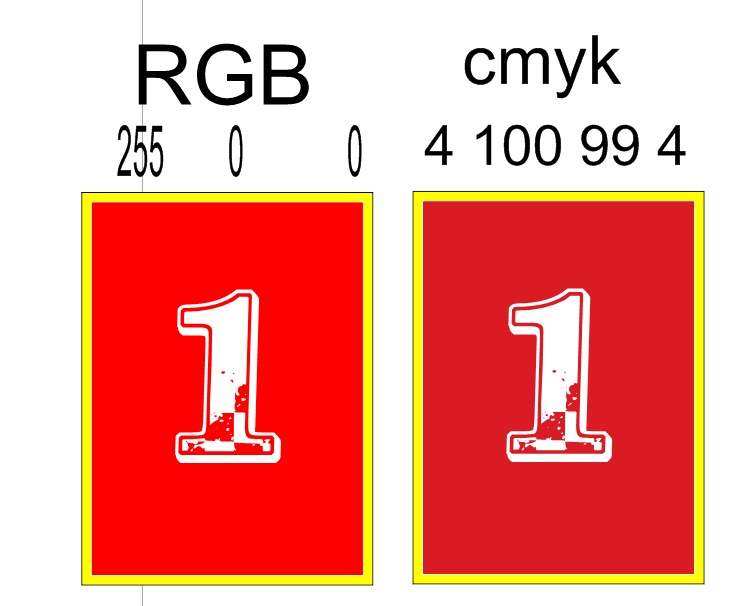

Thanks , This is what I came up with.
That looks like a screen cap, is it?
CMYK on the screen will look like that without a properly profiled monitor set up to show color proofing.
(I don't bother with what the screen looks like - because my customers don't care either).
If that is what came out of the printer and you took a photo of it then something in your color management needs to be changed.
Hmm, they both look red to me. I have posters I printed with cmyk and rgb colors. I let the customer pic the color they want and thats the one I use. You can print out the paletts from corel within the pallet management I think. Works for me, since I have no idea when these guys start talking about all the profiles and whatever.
