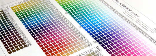

Don't forget to take your test prints outside, away from fluorescent lighting, to get a better understanding of how it will look in a real-world capacity. We have had problems in the past with reds, tans, greens, greys, etc. turning colors after the customer takes them outside. I would say to print your Roland Color Library chart, take it away from artificial lighting, and make your selection under some good ol' sunshine. That should give you the accurate depiction you are looking for.

phototec
Yep, this works for me, just print out the Roland color chart for the reds on the exact material you will be using, laminate, and have the customer select whatever red he likes, I would have him view the chart in the daylight, not in your shop (lighting).
Then you should be able to match the red selected by the customer perfectly.
See page 4 from the link above.
I have these Roland color charts printed on each different material I use, and it helps me to get closer to colors than matching PMS numbers.

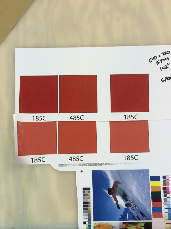

Sadly I am back here looking for help once more. I keep failing at making a true RED ... I tried what you guys have stated here 0-100-100-0 but it's just not red. I sold a few more graphics kits to people and have refunded all of them because they say it's orange.. I really don't know what else I can try , should I use a different formula and export from corel into CYMK ? or what am I doing wrong.

deegrafix
I have one customer that I have this problem with and I have ended up doing his particular decals in photoshop, using Pantone 185, maxing the saturation then lightening it 10% and printing 2 pass. The red is fabulous but you will have to really play with any other colors, making them very light so they will come out the right color. Everything will look very strange on the monitor but you can do swatches for the other colors so you know what you will get. I have several "color families" with the Pantone numbers printed on them on vinyl pinned to the wall so I know which color to choose to get the one I really want. Very unscientific, lol. I have a 6 color old Roland printer. Takes some trial and error setting up the job and longer to print but the red is very nice. Without 2 pass I can't seem to get a good red either. My Roland printer will always do a brighter red using an rgb jpeg file rather than cmyk or any other file type, so even if I design in vector I'll drop it into photoshop and make a jpeg to print.

autoexebat
Yeah the photoshop deal wont work with me as I'm going it all in vector in Coral X6 . I just fired up my printer and will run a test with RVW-PR43K
