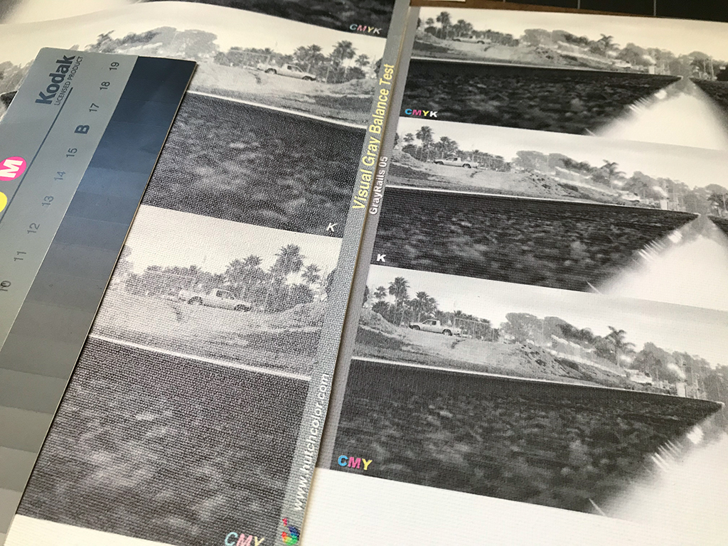

The OP's posted image does not show signs of gloss differential. The sheen exhibits no difference in the darks or lights of the tree branch.
The attached image is an example of gloss differential, in this case, due to over-inking upon initial RIP setup.
I might suggest that you take a more critical look at the image posted by the OP in post 16 - specifically in the dark browns and black areas of the image, compared with the lighter pastel colors. There is a significant amount of gloss that is visible only in the more heavily inked areas in the image, versus the more lightly inked areas, with vastly more gloss than un-inked areas.
Moreover, the gloss variance was enough to warrant an objection from the end-user.

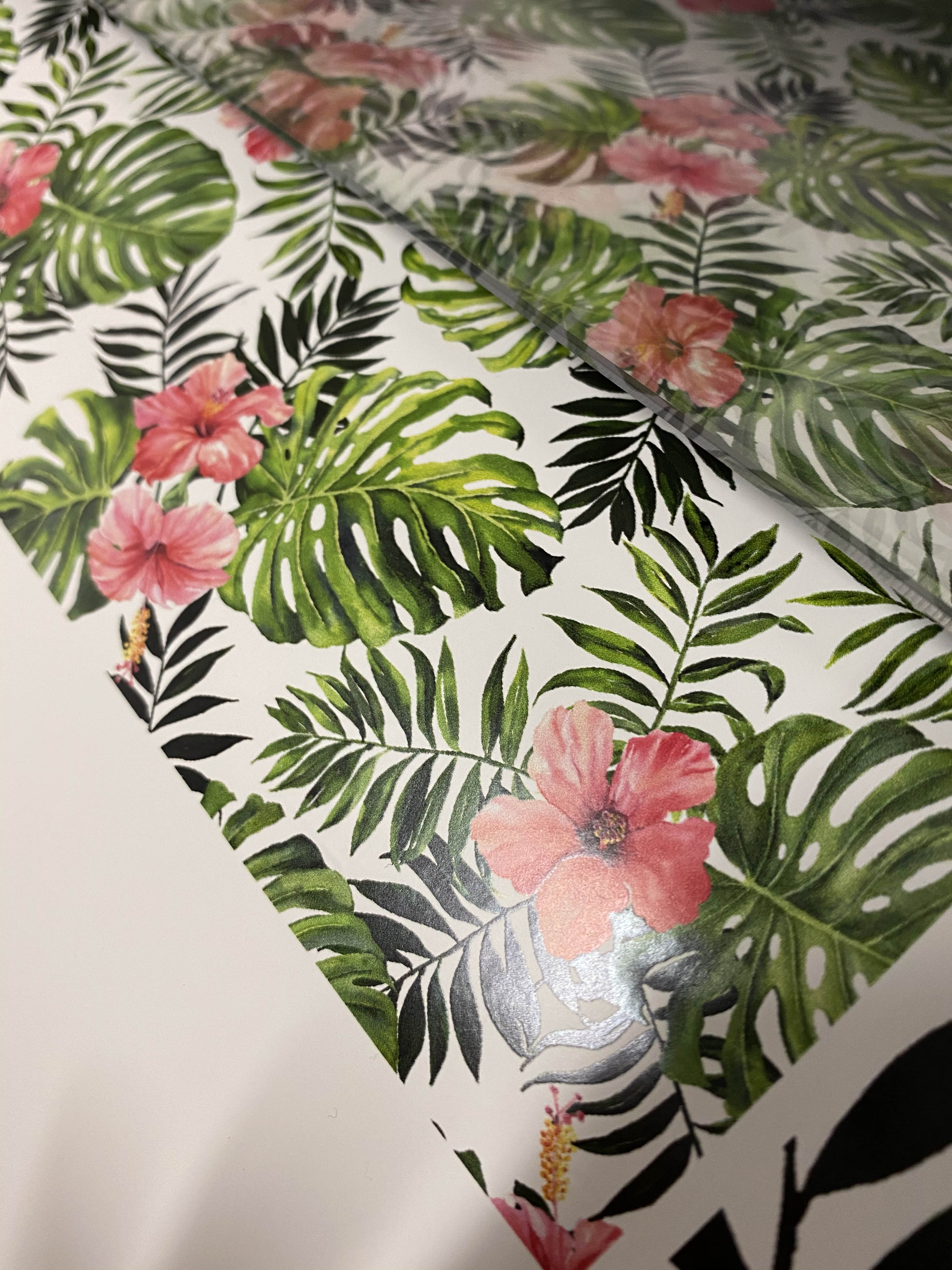

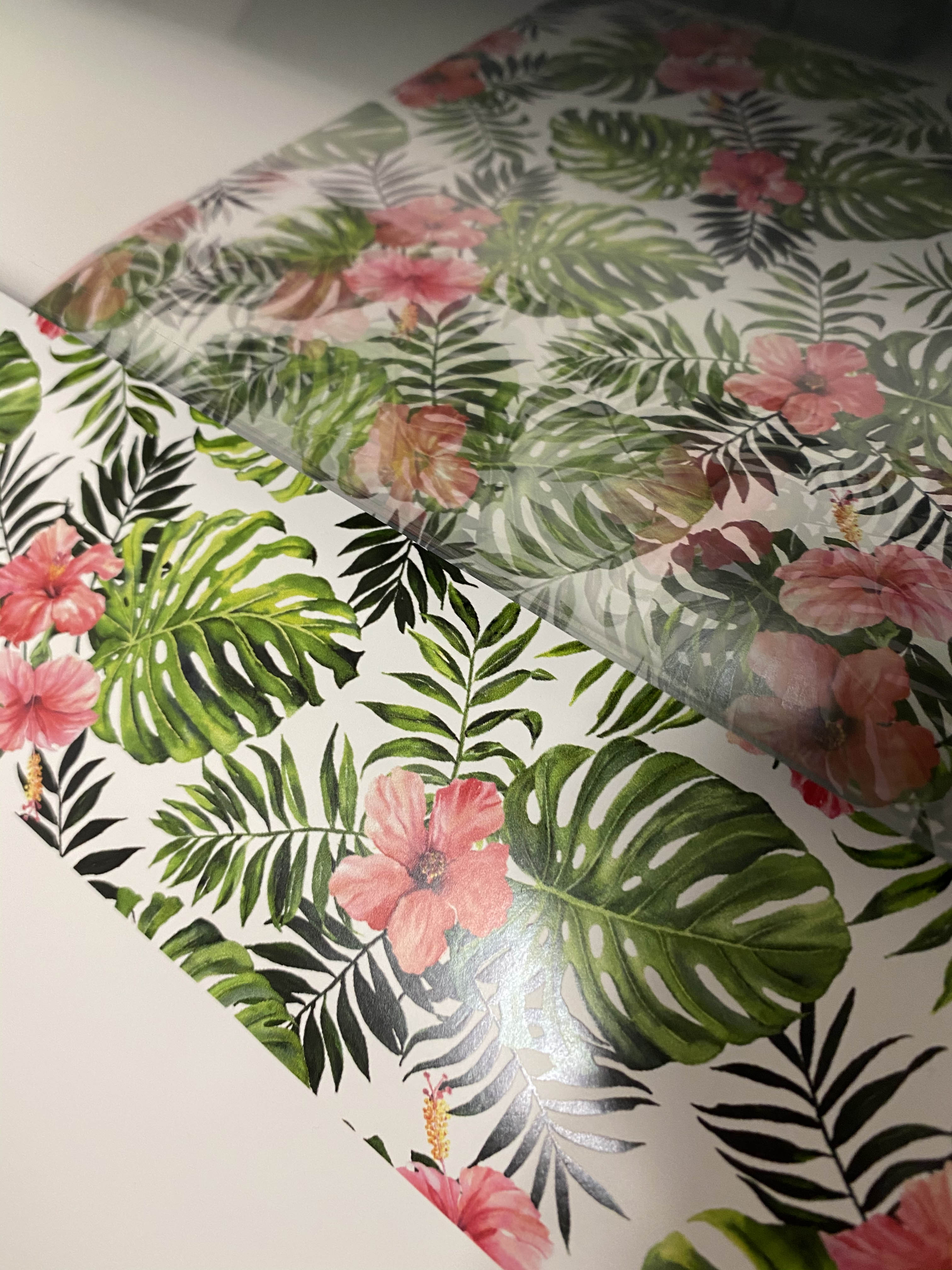

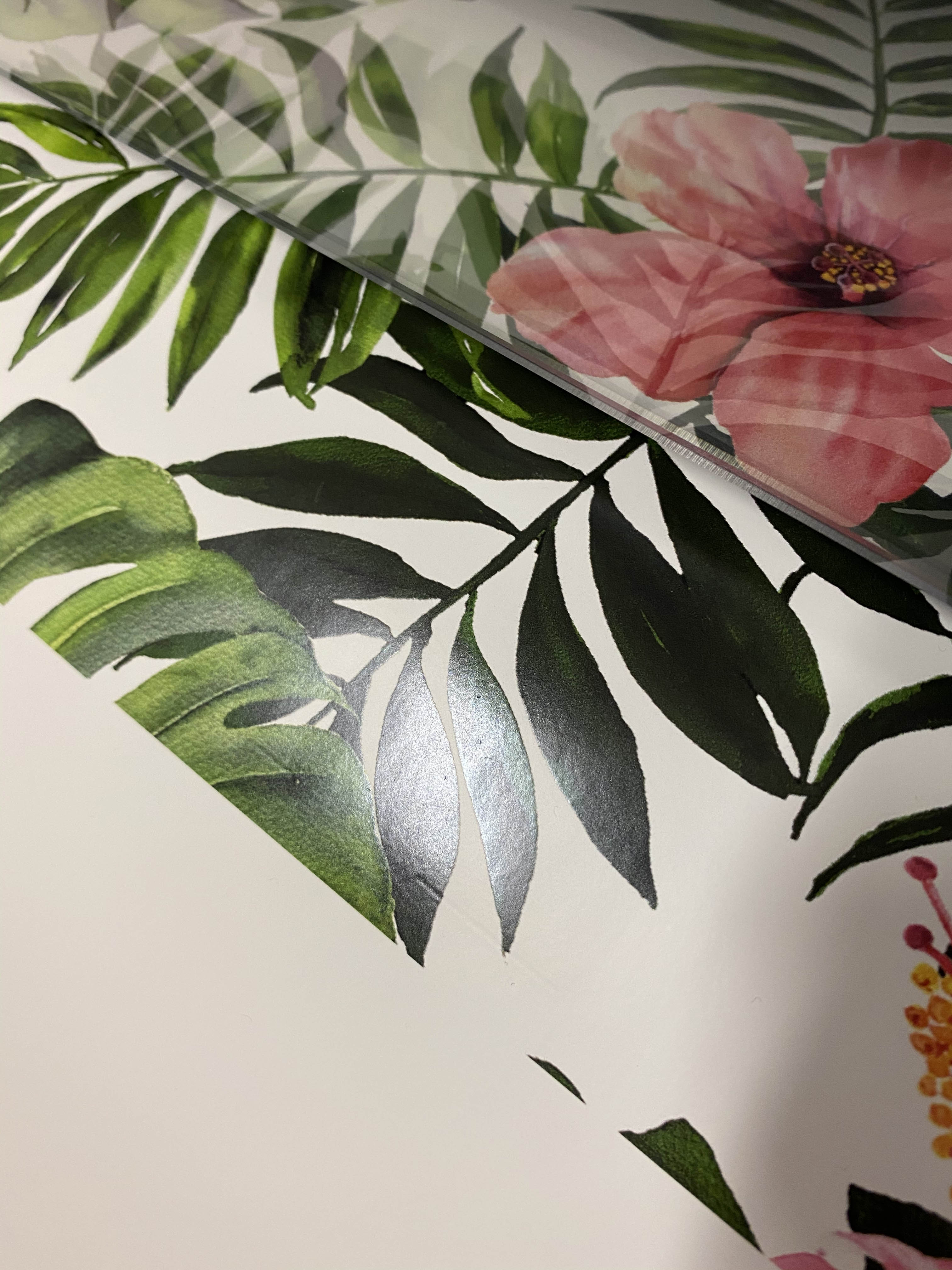

Here is another instance of how shiny (glossy) my S40600 prints are even with Key Banner Matte media profile, suggested by Grimco Tech (pictures attached). Also it seems like the inks are not infused in the media, instead they seat on top of it: is it normal with Eco-Solvent inks (I am not really familiar with technology behind it)? I get that Eco-Solvent inks have some shine on it, but should be that bad? Or this just me already exaggerating the issue?

To fix the ink limits you would have to redo the profile. Do you have the equipment necessary to make a profile?
lora
I am printing on Avery Dennison 2611: used 6 pass profile for this media, then switch to Key Banner Matte profile and getting the same results. I don't have the equipment to redo the profile. What could cause those limits to go too high or low?
Thank you
lora
We have an S80600 so the same ink as you, when we print on matte material the end result is matte, however there can be a slight sheen difference between light and heavy coverage areas, perhaps this is what the client is seeing? the only solution for this is to apply a laminate over the print.
