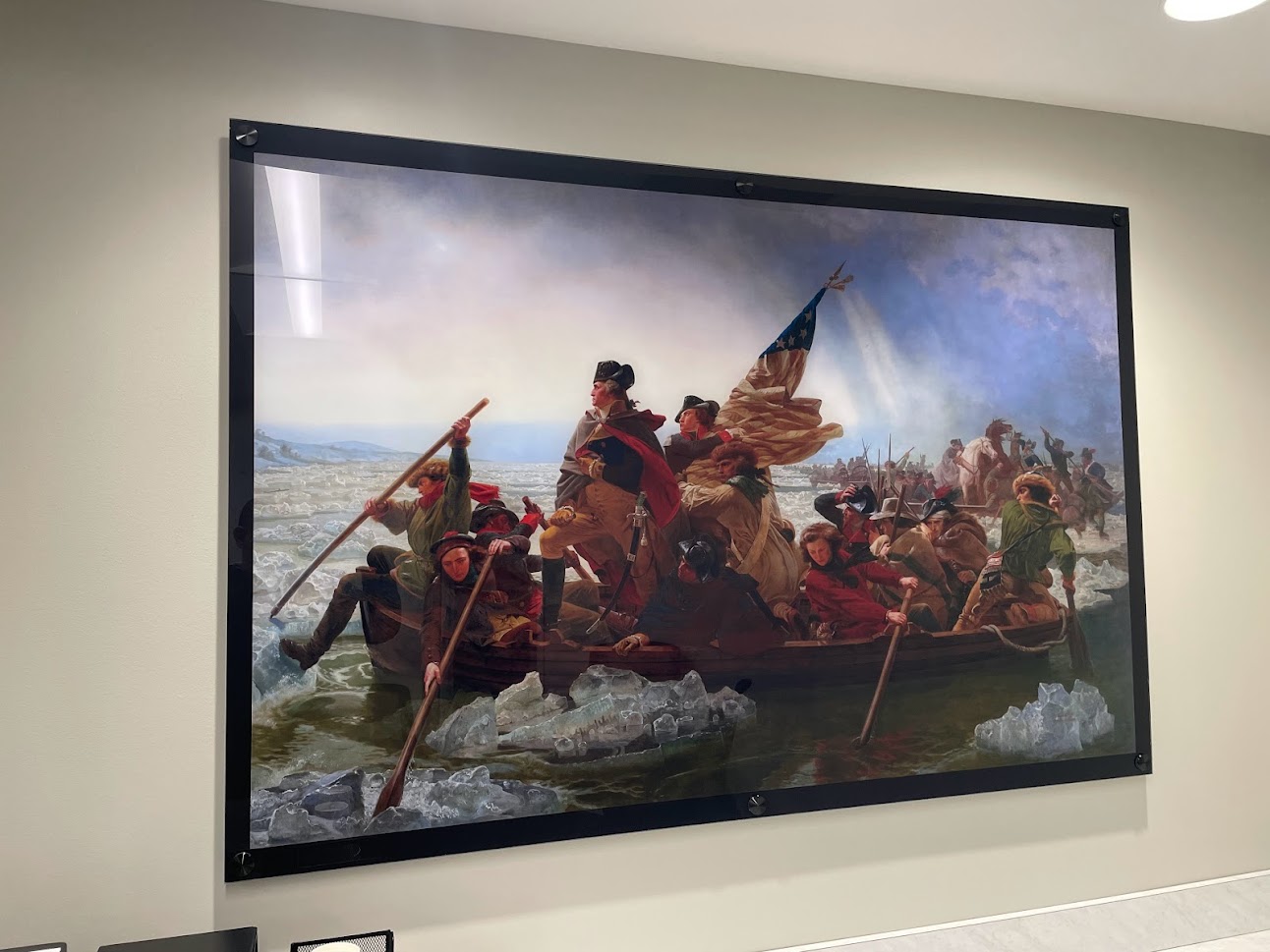

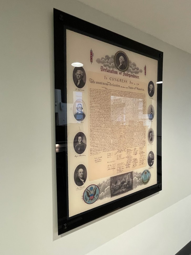

Signs365 is not offering this type of product. They sent me a print on acrylic of the Declaration of Independance with stand offs last month. It looks really nice. We actually did something similar we printed on the HP R1000.
