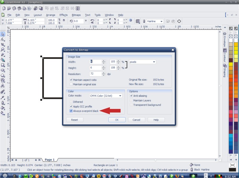

If youare "EXPORTING"...is "always overprint black" checked?

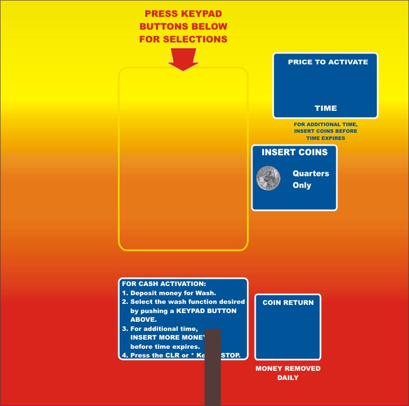

Sorry - early morning. I did mean Export, not Save. I don't see where to check the Overprint Black? I don't see the option. Here is an attachment that shows what I mean. I am referring to the black rectangle at the bottom of the yellow/orange sqaure. That is not supposed to be there, and when I am exporting and looking at the preveiw, its not there.

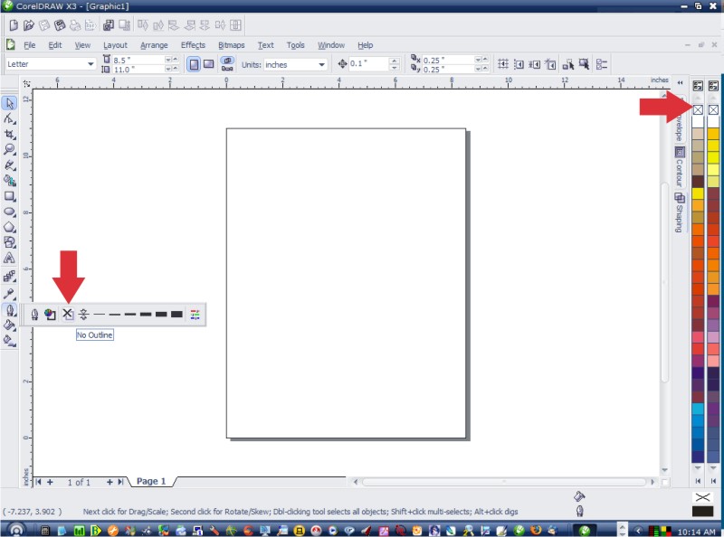

That appears only to be....
an outline around your gradient fill.
Get rid of it at the arrows.

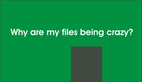

Here is another file!

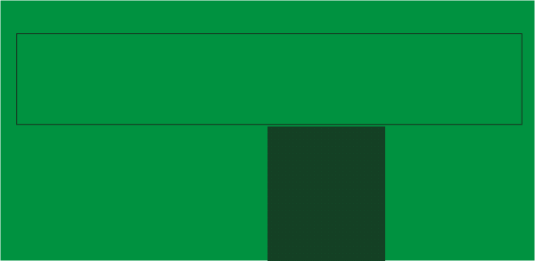

and here is another case with an outline box in the middle - the black box still appears in the same spot. it's like it is haunting me :smile: it also appears if I save as a GIF. cutting and pasting doesn't work either.
