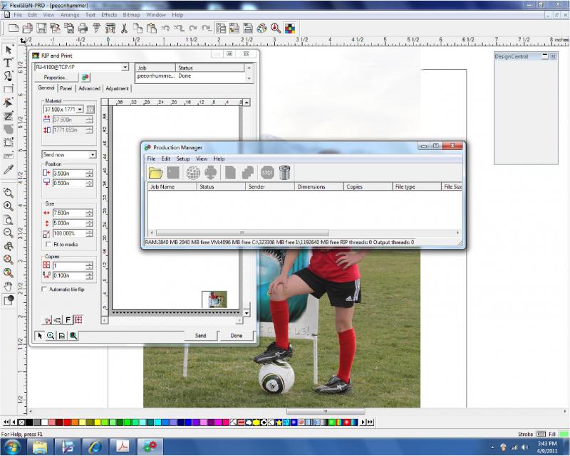

Here you go
Put you mouse near the left side of the window, the mouse will change when you put it over the divider bar. Click on it and slide it to the right and you will be able to see your printer and cutter.

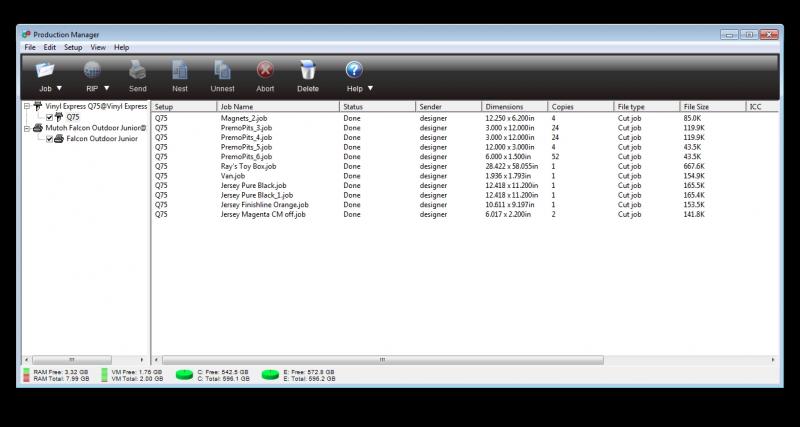

Its not that I can't see my printer and plotter. It is my jobs do not show in the production manager when the jobs are printing or plotting. In my old flexisign the jobs showed in production manager when printing, holding, ext. In production manager I could reprint without ripping again and I could delete job with error or any job one it was in production manager
There is two windows in the production manager. One shows the printer and cutter the other shows the jobs. You can see the one that shows the jobs but you have to select the printer or cutter in the left window to see those jobs.
