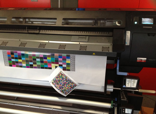

Enclosed Picture:
In the Printer the first 132 Patches of a ICC-Calibration Chart printed out of Onyx for the internal spectrophotometer.
Taped on the Vinyl in the Printer: a 900 Patches-Chart for our Barbieri Spectro LFP.

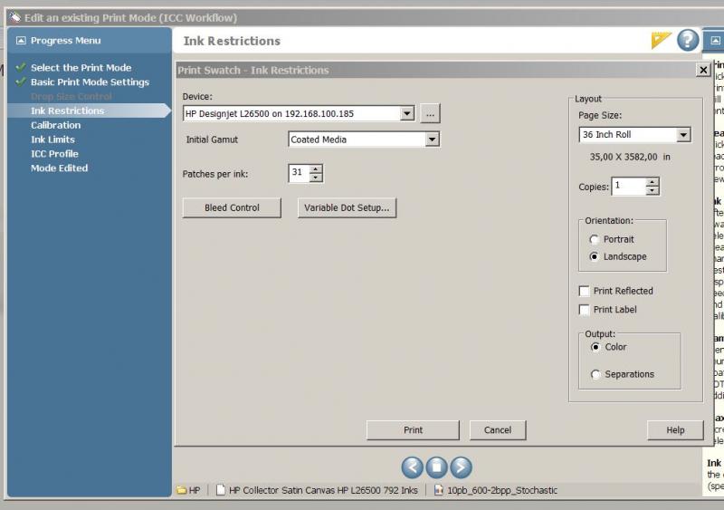

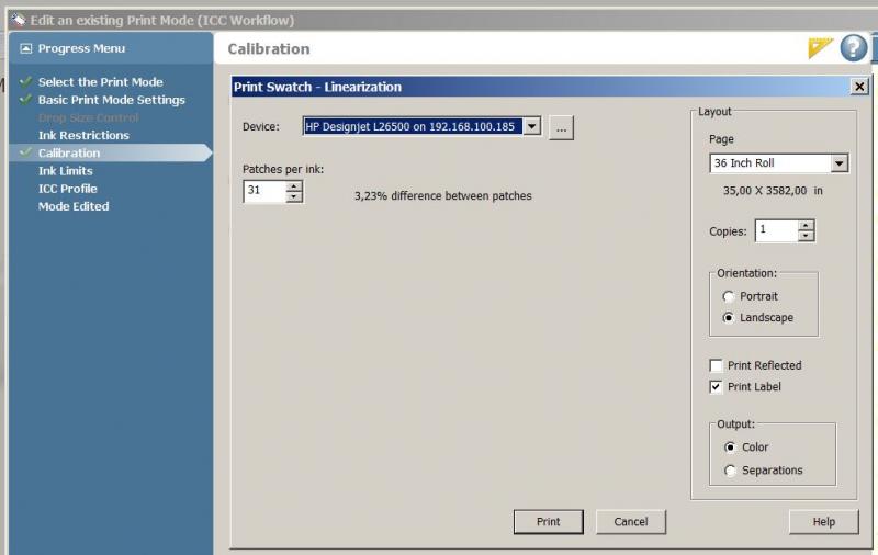

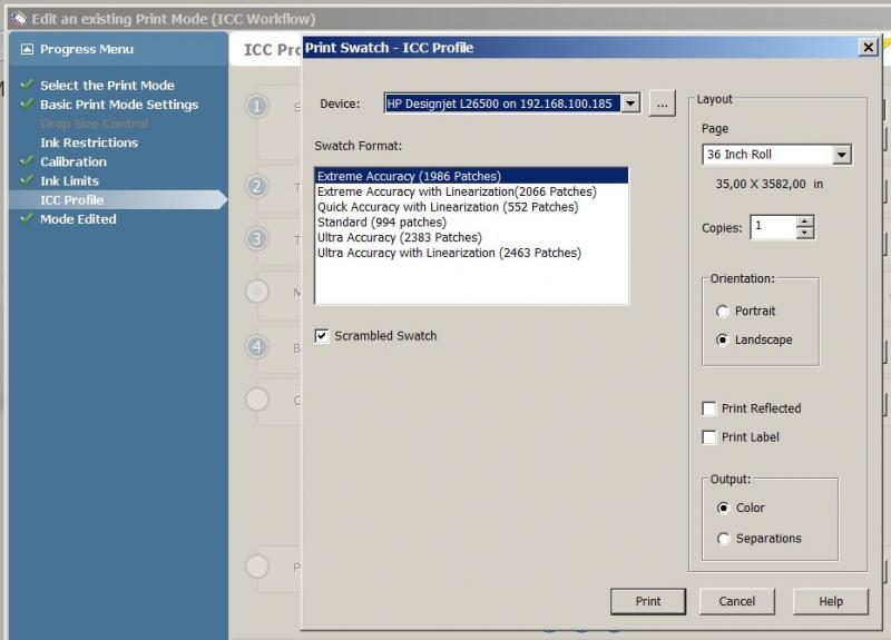

You can set up the built in spectro for every single step of the calibration process (see enclosed pictures 1, 2, 3). It is the same in FlexiCloud. The swatch of my sample photo is an ICC-Swatch.

I think your confusion is a result of that the HP Z6100/Z6200 have a built-in Color Management, with the possibility to create internal profiles for using this printers without a software-RIP. The Latex don't have that.
