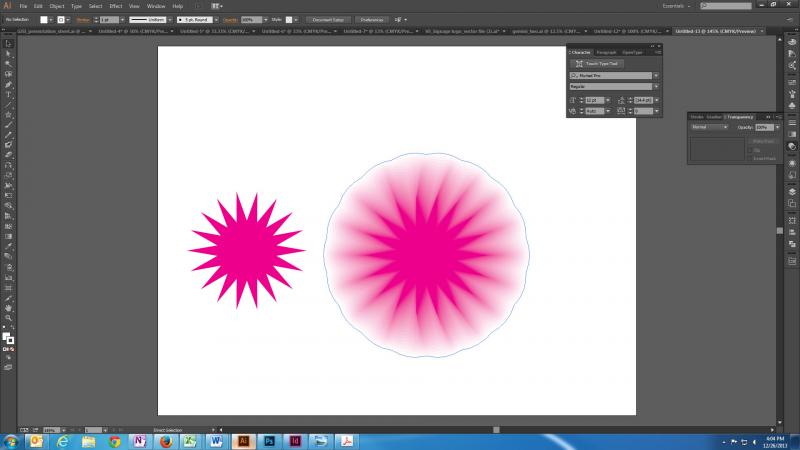

rdm01
Take shape, outline it to desired ending point, change color and opacity to desired ending point. Go to path>blend>blend options and change it to specified steps and then specify how many steps you want (sample attached is 20). Select the two shapes and perform a blend.

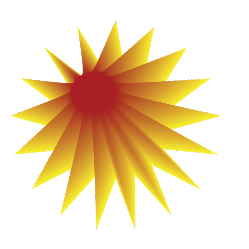

Vinylman
VARIATION on theme
Here is a different iteration of the tute above.
I started with an oval. [fill with your choice of color]
Then created a star.[fill with your choice of color]
Moved star to rear.
Centered both items.
Went to blend mode [ under OBJECT MENU], blend options. Set these to your personal settings.
Select BOTH objects.go to OBJECT MENU, scroll down to "BLEND".
As an after thought I decided to see what else I could do!
I DOUBLE CLICKED on the finished art work, and then I was able to move the original OVAL shape anywhere over the star, and the effect followed and made some interesting NEW EFFECTS.
I then selected the original oval, and began experimenting with changing it from an oval to a circle by moving the "handles" on the perimeter of the shape.
This is the result.
Go HAVE SOME FUN!
