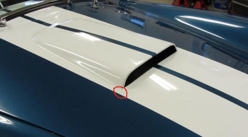

Here's how I did it. I think I could do it in one piece if I used air release vinyl but with Oracal 751 I ended up with a 1/2" seam at the front edge of the scoop on each side.
The excess width of the stripe was cut after the scoop was covered. Eat a banana or two before you cut on the car!
so, you have two seams on the hood?

Thanks John. Wouldn't air egress look like crap though? The only stuff I've ever used was 3M 180 and it looks like a waffle cone to me. Have they improved the stuff?
they came out with with a new version without the waffle cone texture. They originally did that so people could identify if it was wrapped with 3M or not.. really stupid.
signmeup
The waffle effect was the air egress. I took normal cast vinyl and rolled it onto some old 180 backing paper. Heated it a bit with a heat gun and... whadayaknow... instant air egress vinyl! It worked just like the 3M 180. They must have come up a with somewhat more cunning technology since then.

How did you cut off that excess on the hood by the scoop?
Also any sealer where that seam is, or butt seam or what 5/8 overlapped?
I can't see it if its overlapped.
Nice job.
To cut off the excess I used a straight edge and a snap off blade knife... and a steady hand.
There is a seam at the front corner of the scoop about an inch wide. I overlapped it about 3/16". Never thought about sealer over the seam. What sort of product would I use?

Sealit pen or 3m edge sealer.
I meant did you cut right on the hood or put some tape underneath where you knew the line would end up around.
I did a half wrap where I wanted a nice straight line on top so I put 3m blue fine line tape across the body line where I wanted it to end. Wrapped above the line and cut on the line. Ended up with too much pressure on some spots and lined the clear coat.
I had to buff it out upon removing the wrap. NO GOOD... Fresh exacto blade and I'm usually pretty good with just going through what I want to cut and not the freaking car. Done it many times before with no tape and no problems but this one got me. I think the tape made me feel like I wasn't putting enough pressure.
These snap off blades never seem sharp enough for me I always use exacto.
Maybe exacto is too sharp !!!
Blue tape was super stuck to the vinyl too.
Use the 3m fine line striping tape!
signmeup
I just cut the single layer of 2 mil vinyl as it sat. I stuck masking tape over the excess on the trunk cover to cut it. Just as a knife guide. Did not cut any of the guys clear coat.
