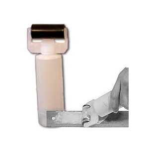

Easiest way to get started is to put it into a squirt bottle and then use a squeegee to spread it out down the hem (don't use the supplied brush). Once you get that down switch to a glue roller and go to town.
wayne k
guam usa
