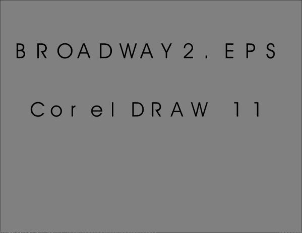

When I 'try' to import .eps into Corel 11, it is a rectangle without an image.
Barry
skjeflo
idsign,
Try that same import but import using the PS, PRN, EPS - Postscript Interpreted filter instead of the plain EPS filter. Most EPS file will work just fine this way. Been doing it this way from version 8 through to 12 now.
I have no clue why Corel even has the plain EPS import. It doesn't work on anything that a signmaker might want to have, at least in my experience.
