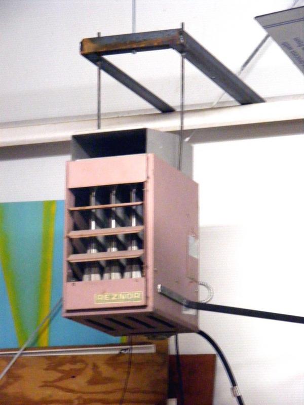

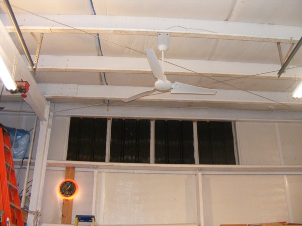

ceiling fans are the ticket. this my 16 foot tall shop, but i got 6"insulation on the roof.... so heat stays in and A/C also. these fans are from home depot 56" 3 speed, and are right at $100 each 2 of these would be a good investment and if you ever move you can take em with ya....
this my heater, 30k BTU REZNOR i converted it to propane. i got 2 30 pound bottles and between the fan and the heater i can hold a 68-70 degree in there.....in the coldest day we get here.
