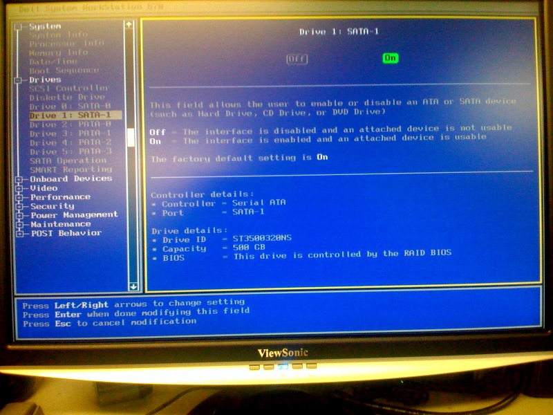

Attached is the screen shot for the Drive information in the bios. This is all the control I have for the drive in the bios, on or off...
Also no new option for Drive Utilities in the RAID controller.

SignBurst PCs
Try this:
Go to "SATA Operation" in the BIOS
Your system probably came set to "RAID Autodetect / AHCI"
Change the operation setting to "COMBINATION"
Reboot - and see if the drive shows up in the OS
If it does, Dell recommends that you change the SATA Operation setting back to RAID AUTODETECT / AHCI (or back to whatever your factory setting was) to avoid any problems with other IDE devices installed on your system.

cgsigns_jamie
Well Casey I scoured the bios and the raid controller for the option you mentioned and I couldn't find it.
I did however (just for the heck of it) turn on the SCSI controller to see if that would help and sure enough once windows loaded I opened computer management and the new drive showed up.
I just initialized the disk and I'm about to format it.
So I guess the problem has been resolved.
