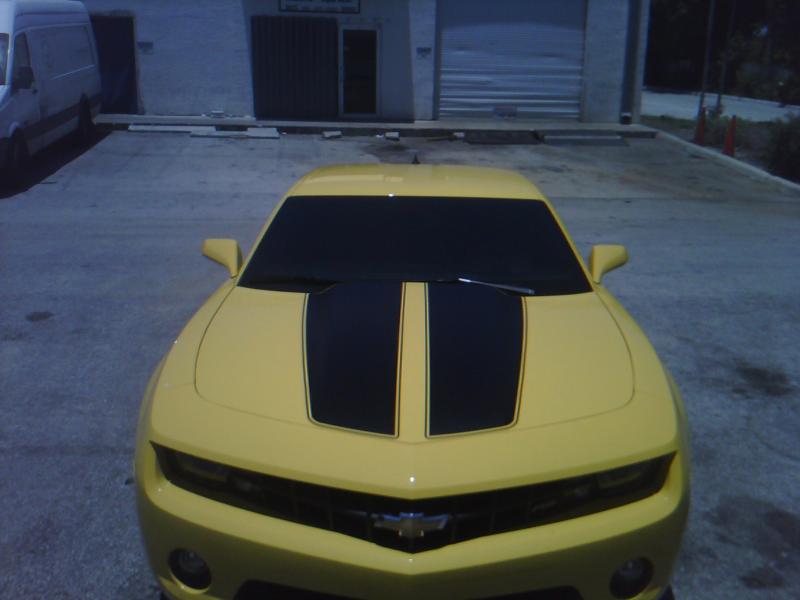

    Plano (Dallas), TX
    We used 970RA matte black on the last one we did....

    Did you plotter cut those stripes? Im having to go all the way bumper to bumper so I am going to be making templates with transfer tape then drawing them in flexi

    That's basically what we did... ended up making templates in Flexi, then cutting the final pieces (did trunk lid and custom rear spoiler too)

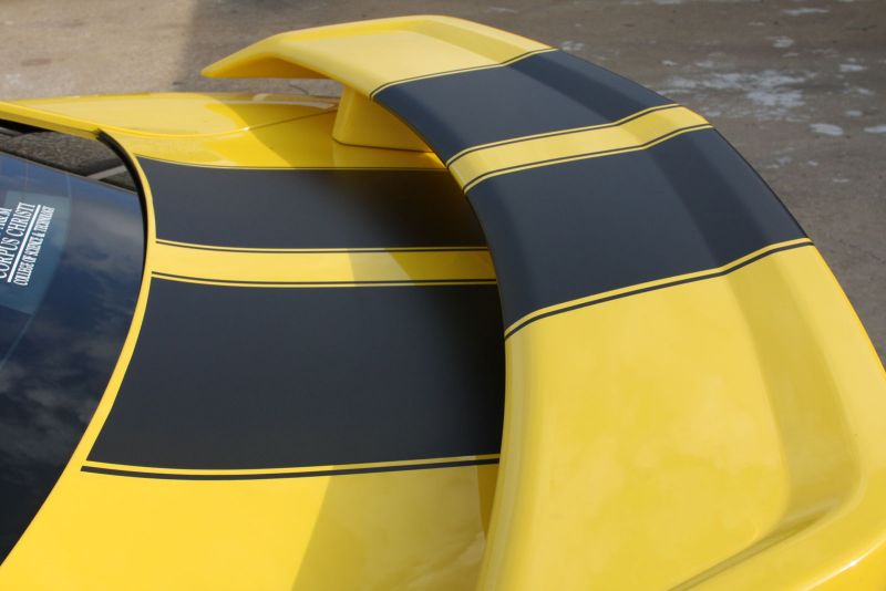

    If you notice in my pic above, we also did the light shelf in matte black. No template for that, just used WrapCut tape to mask where I wanted the line and wrapped it.
    Here's a shot of the back, which I also templated and cut with the cutter.

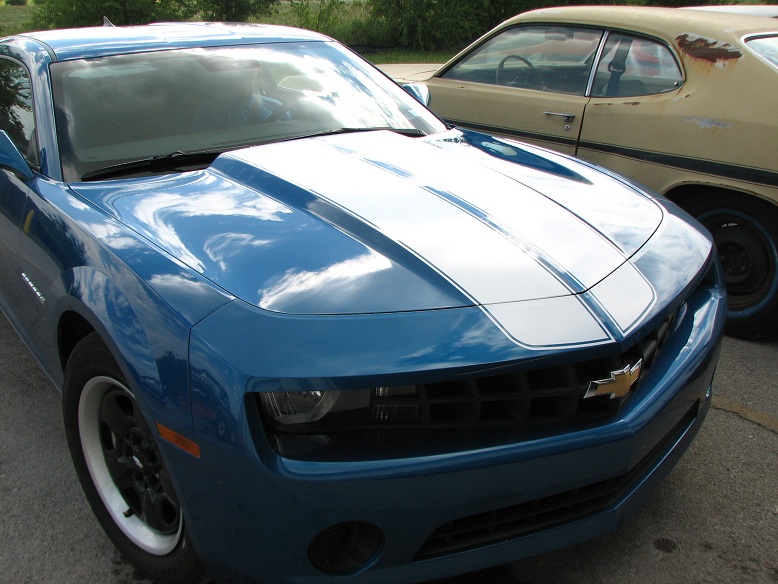

  19. Really?!?! I install Rallye Stripes on Camaro's quite a bit. Never had it take more than 3 hours and that was because the customer was sitting there watching me and I did not want to make it look too easy. I wish i could get $800 for them!
