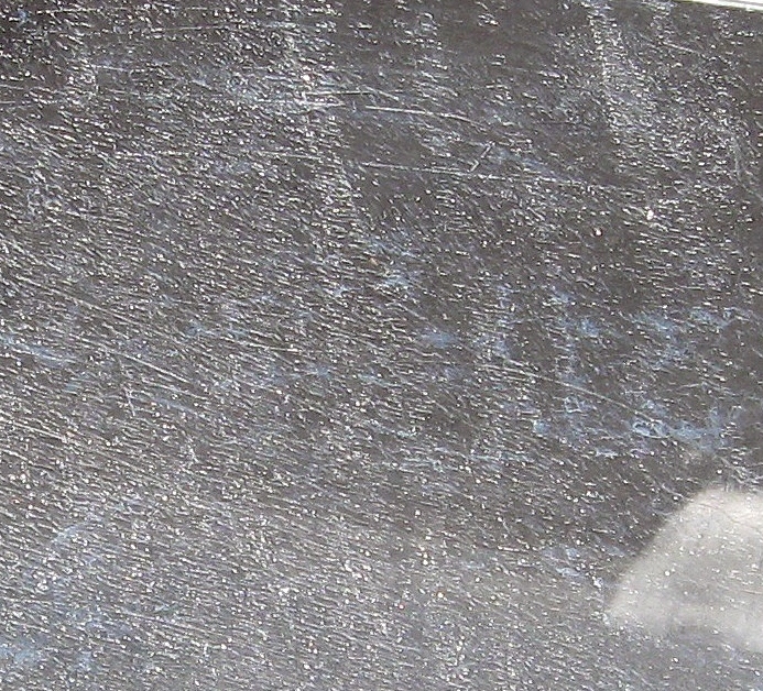

    after last week experience with alchol on acrylic, cracking the sheet
    can I use rapid tac on acrylic?

    :goodpost:
    This is crazing like you would get from alcohol. The picture you posted, looked more like someone hit it with something.

    Does that crazing glow when edge lit?
    Seems like a cool effect added with some sandblasting if the integrity of the panel isn't compromised.......
