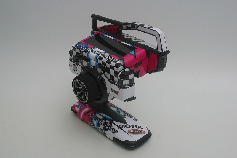

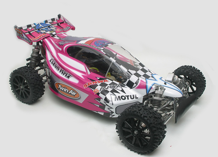

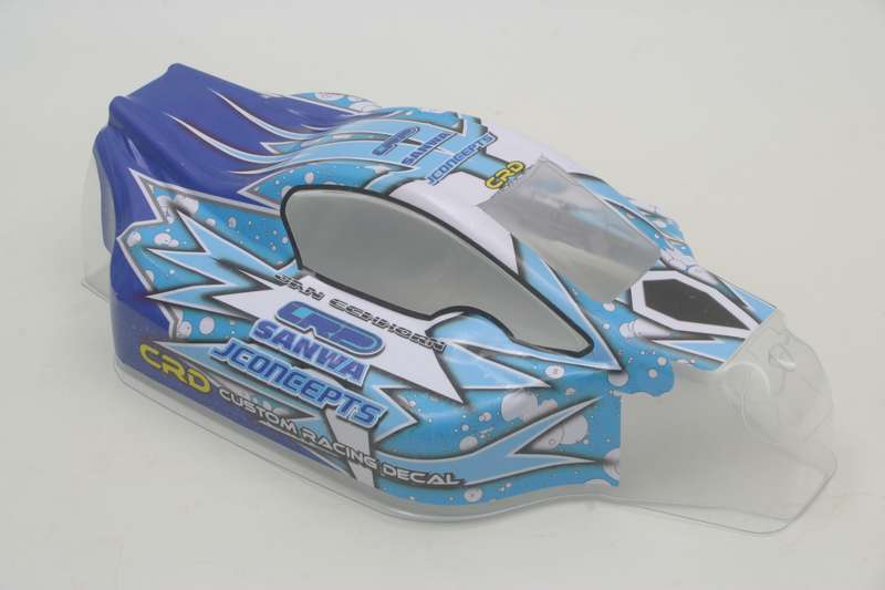

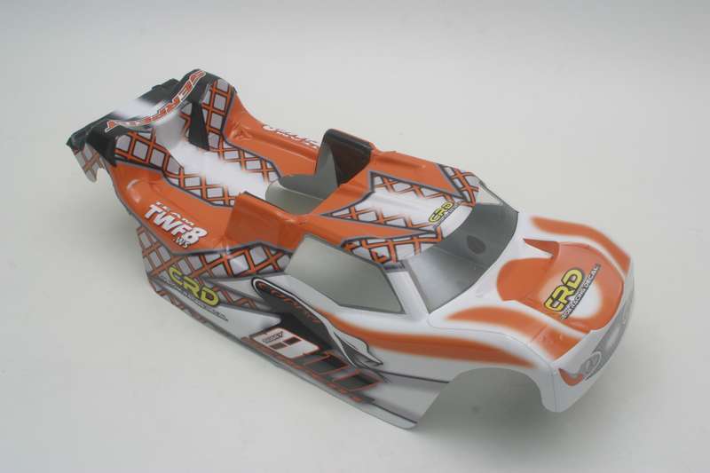

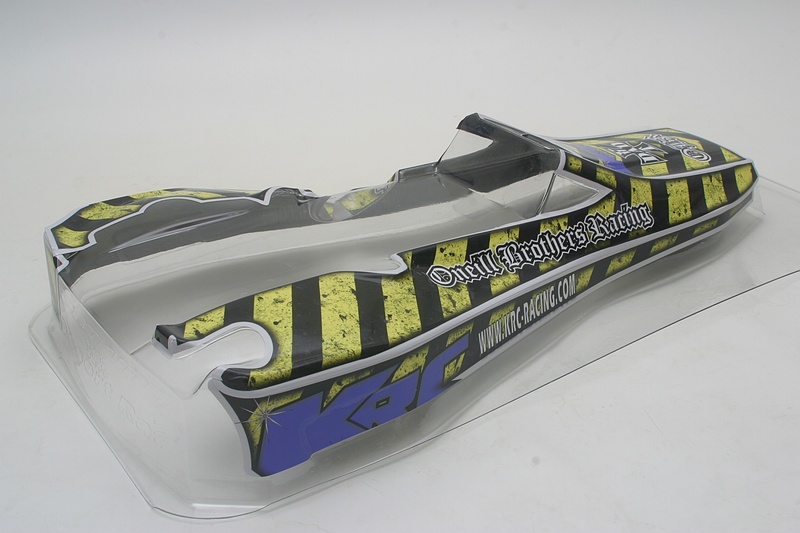

Remember for 1:8 scale buggy the lifetime expectensy is around 1 year depending on the crashes. Vinyl enhaces the strength of the PC bodies as we at CRD do not use an polycarbonate paint. They are full body wraps. Paint weakens the edges over time making the body prone to tear.
We apply the decals which are panels for a fee or customers do ti themselves and we provide manuals for each type of body and some are even video manuals.
