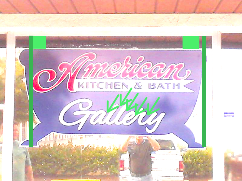

Yeah, the Big guy in the picture with me. He did the majority of the work. He is a member here. Have to track him down and find his screen name on here.
Edit: Found out his screen name here its Tone_S he will verify it went on straight he measured quite a bit too.
Hmm. I've seen these "inside 3rd party" surveys before. Not accusing anyone, but they are easily rigged.
How about a 4th party that wasn't involved in the actual install but saw multiple measurements being taken and would testify to the fact. An "uninvolved" passer-by if you will would suffice. If they even read the measurements it would further support your story.

The best looking picture is the first one.
Bathtub...meh. Two scripts in the same layout.

By the way, unless the building has settling problems.... you and your helper must have one longer leg than the other....... You are almost dead-straight back. It's not like you're taking the picture from next door and having a small perspective equation going on. We have a rule in our shop... if anything is off more than a 1/16" over two feet... it gets done again.... at our expense. That thing looks about an inch off over maybe five feet. That's almost 1/2" every two feet. I'll bet you anything, you're gonna get a call back as that guy gets responses from people with two legs the same size... not walking around with their head tilted all day long about how crooked his window dressing is.
.......oh and what's up with your kerning ?? Most people mess up a letter or two, but all of yours are different.
This kinda chit don't lie. The space at the top and the bottom are off. No angle or sloppy picture taking is gonna overcompensate for crooked eye lines. Don't get me wrong.... it's still just a crooked job as Jill said...... Bathtub...meh. Two scripts in the same layout.

what is up with that big a$$ phone number???? who cares where to call if you don't have a clue as to whom you are calling? Company name, what they do are the two important thigns and then where and how to contact.
as far as the tub goes, that at least, looks somewhat better than what you started with when you first "designed" it. it is off or that is one strange optical illusion.
poster way to crowded to the edges as others stated.

Measuring too much can at times cause problems. Measure, pin the graphics, stand back, look at the the most Prominent body line, does it LOOK right, not always. Make it crooked if you have to so it Looks correct. The phone number is un even over the most pre dominant body line, the Lower one. The rear door is even, so compared to that it looks crooked. Still a good job, seen many worse, especially mine when I used to work off levels, not adjust the average distances to get install line. I run a Laser level at the angle of the main body line now, and measure off that.
