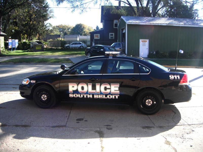

  6. OlsonSigns601
    OlsonSigns601 Member
    405
    Jul 23, 2011
    That is what we did here.
    It worked out great and we got to use the same quality reflective we had used for years. Its been 2 years and still looks good today.
    Although reflective is pretty thick as it is, adding a layer of vinyl and laminate means its really thick.
    That is really the only down side.
    The upside, is that if your print gets screwed up its not nearly as expensive to replace as the reflective.

  11. Mosh
    Mosh Major Contributor
    5,809
    41
    48
    Oct 19, 2009
    Nerbaska
    Pretty much end up with two layers of clear and one reflective, works pretty well. I only have a call to do ths 3-4 times a year so can't justify sitting on a whole roll or printable reflective. I have some Police cars been on there 5-6 years with no complaints.
