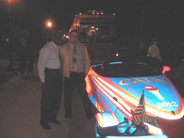

This wrap sure looks reflective... 3M 680 is all I've seen that could maybe do this... anybody know?

I use reflective all the time and when placing an order with 3m they always ask me if I want flexible reflective or not. I use Egineer Grade and High Intensity

I print on Oracal Inkjet receptive reflective occasionally. Flat panel installs only. It looks great at night.
3M has the only air egress reflective out there at this time.

i have seen this advertised over the past 6months or so. haven't used it but looks pretty good. the thing that worries me is reflective seems to tear real easy not sure what they did to make it flexible/stretchable

3M IJ680CR is the way that was done or to do a similar job.
We use it on the rear of vehicles for printed chevron striping.
Goes into recesses well, stretches pretty decent for reflective; try not to lift/bend it much but doesn't show that bad when you do.

Arlon makes a 5mil printable reflective DPF 2400. But I think it was probably the 3M IJ-680-10 since that has the Air egress on it. HERMAN CAIN WOOT!!!
