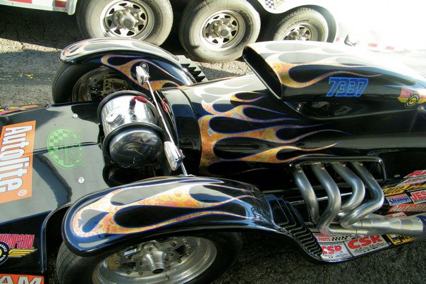

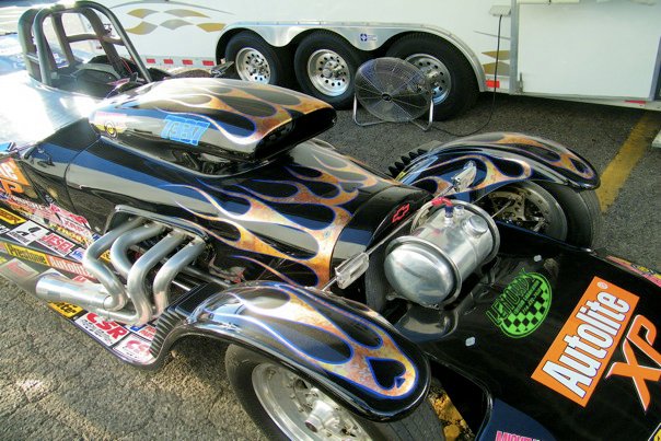

great and profound post Gino! I don't do surface gilded leaf as much as i used to, but when i do, it still is as much fun as it ever was....the problem is having customers that appreciate it enough to pay what its worth. I still do stuff like this now and again....it aint a fire truck but you get the idea.
