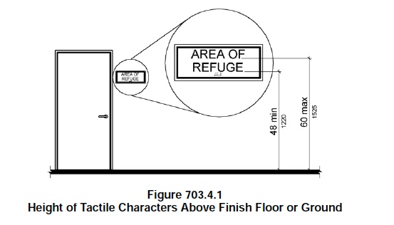

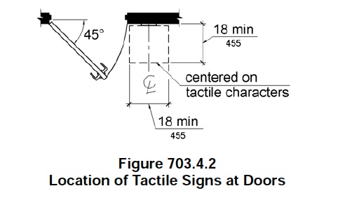

I'm assuming these are door ID signs... are they ADA compliant?
You know there is a code requirement on where they are placed...
View attachment 127926 View attachment 127927
That's always a fun discussion- because the customers never seem to grasp that there are only very specific instances where ADA signs may be attached to doors (no matter how many time you read the related section of the ADA guidelines to them).
