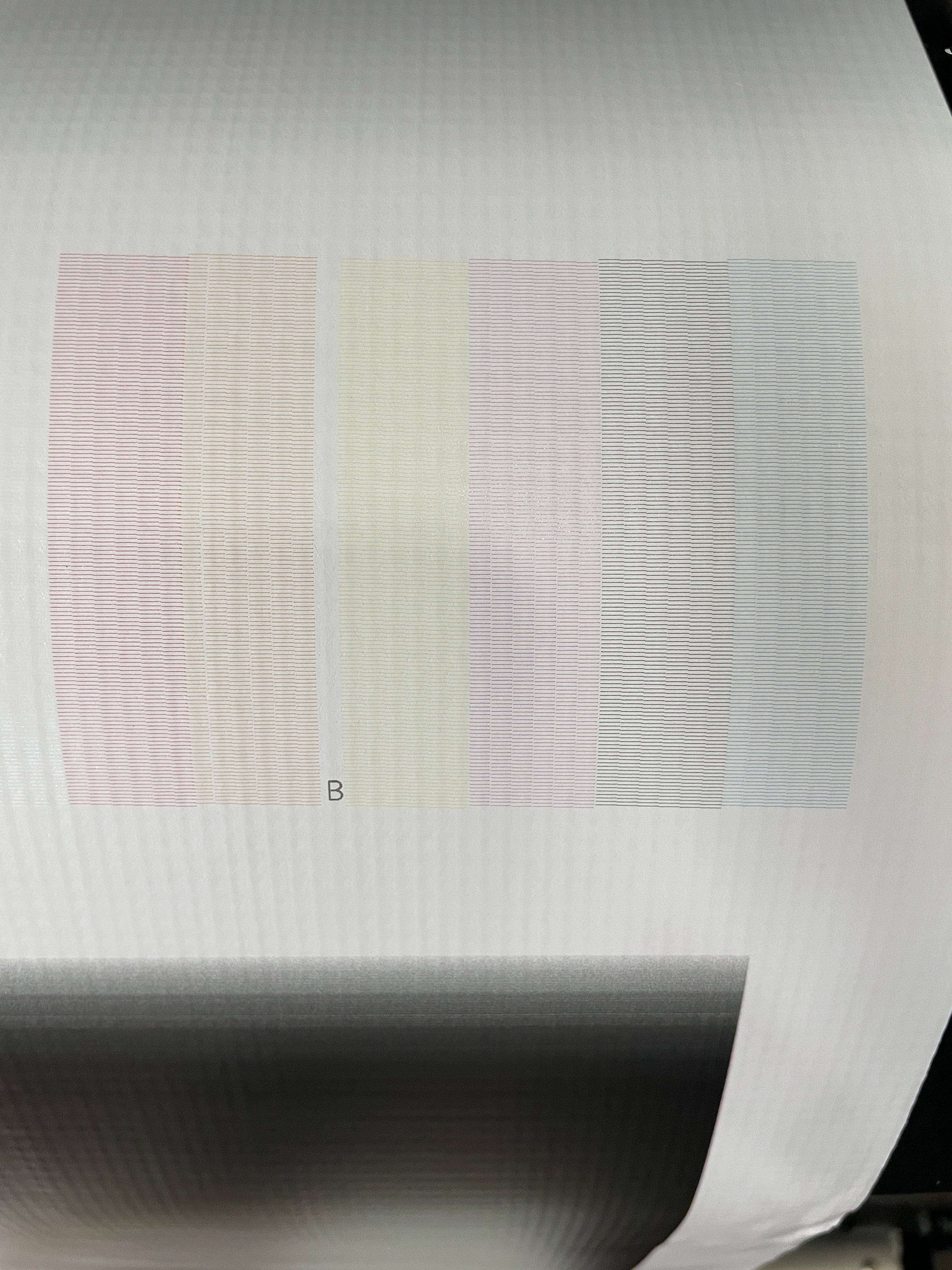

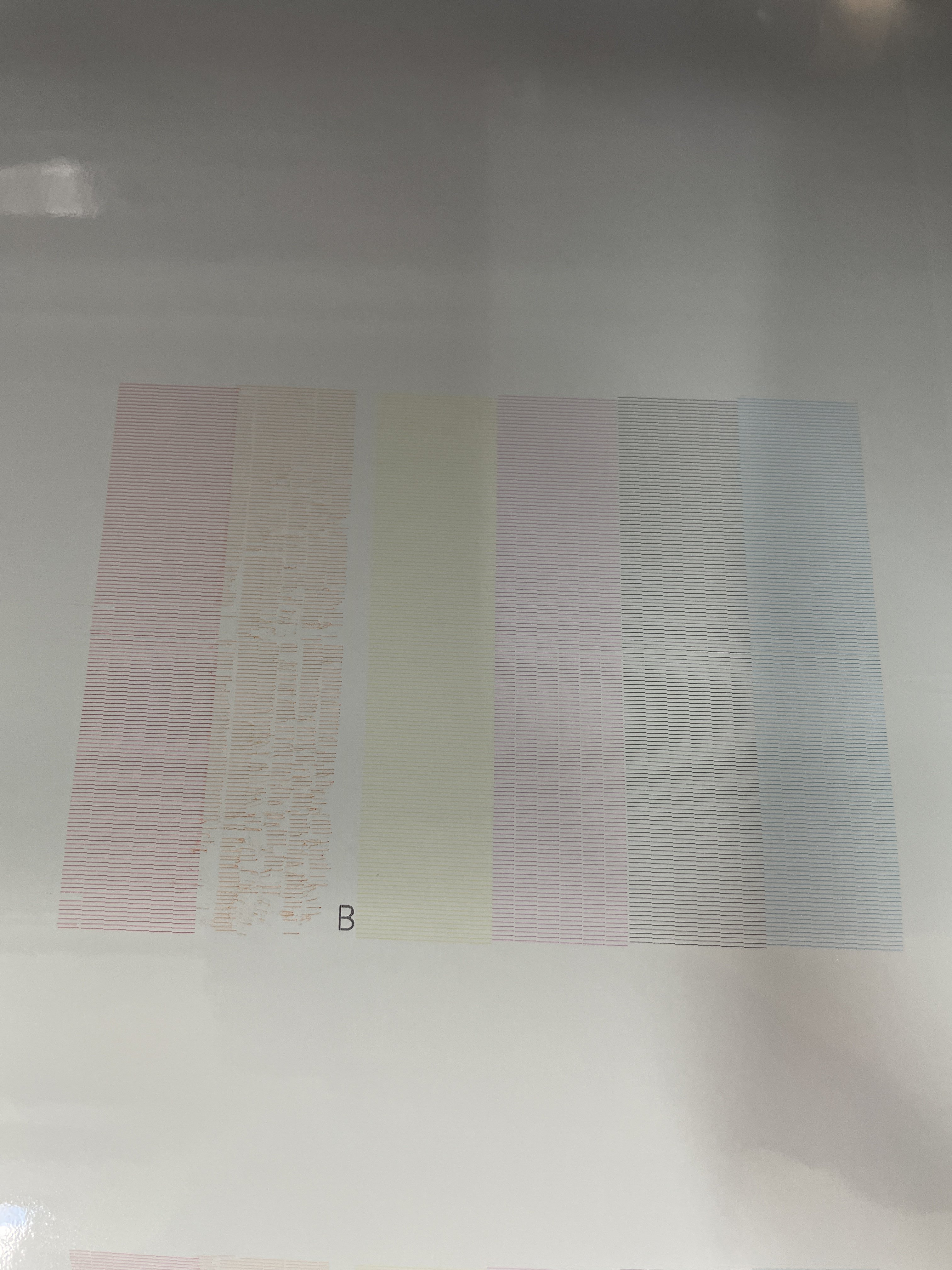

Surely the print order is set in the rip? We regularly print white on top of cmyk by choice.Small update on our new machine - 4th day of having a tech here, Roland's tech came out to swap out the head for a new one. Exact same result as the previous head with orange missing completely and the same missing nozzles on the red channel.

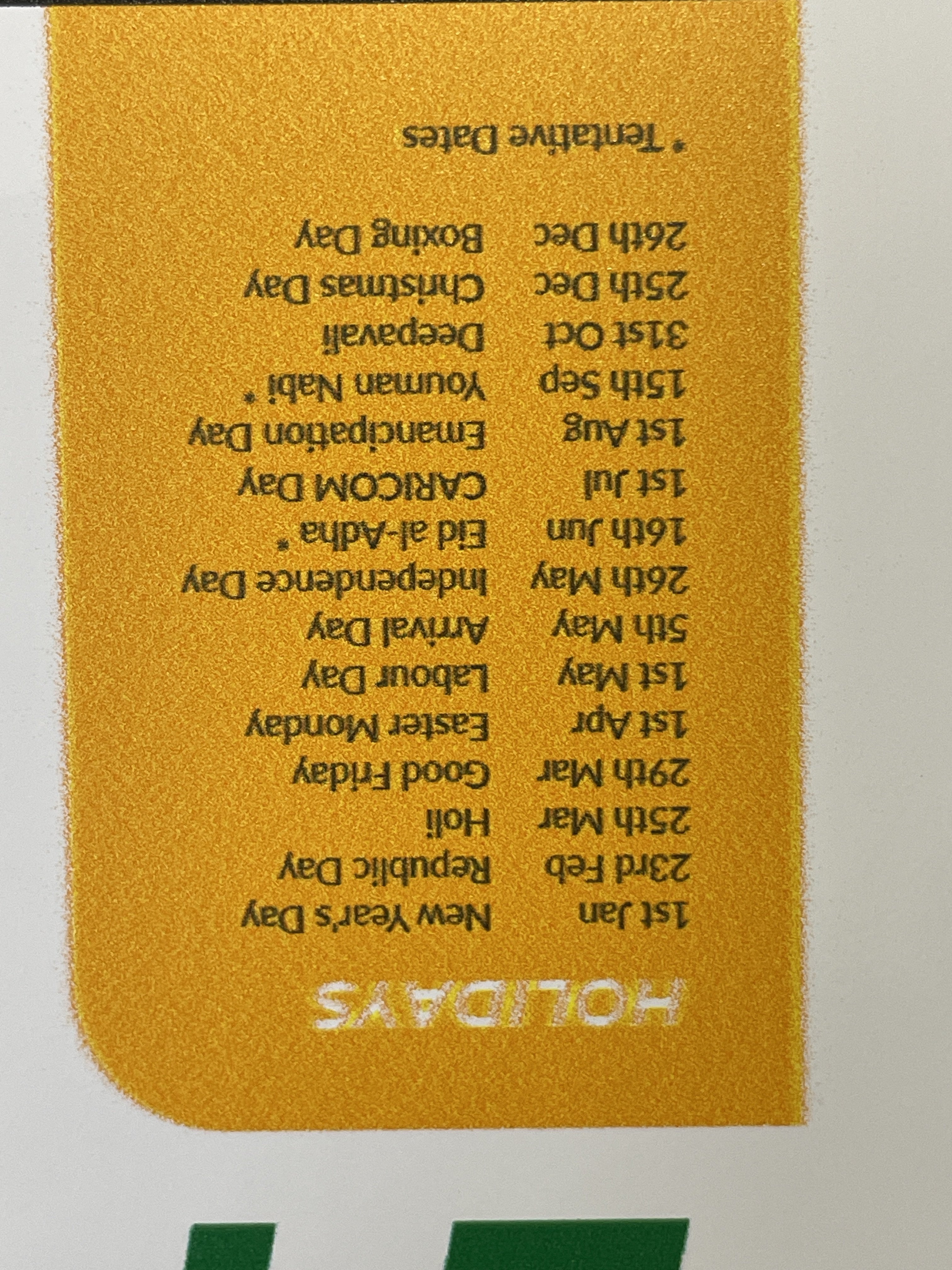

Roland tech also realised that the machine has been setup incorrectly - laying white on top of CMYK rather than the other way around. Another layer of things to fix and correct...
Heads are staggered, so the order that the heads are physically in determines whether you can print white over/under without the need to pullback the media.Surely the print order is set in the rip? We regularly print white on top of cmyk by choice.
Ah ok. Interesting. We are running an LG-640 with a single 8 color head.Heads are staggered, so the order that the heads are physically in determines whether you can print white over/under without the need to pullback the media.
Having them in the wrong order means halving the print speed as it has to feed the media back for the second pass.

Did you check your ink expiry dates for red and orange? We lost red almost completely (only a few nozzles remaining) then switched to new ink, renewed ink and the head came back to perfect condition.
