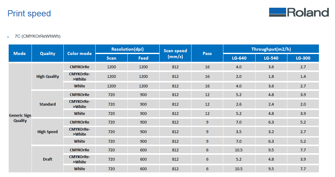

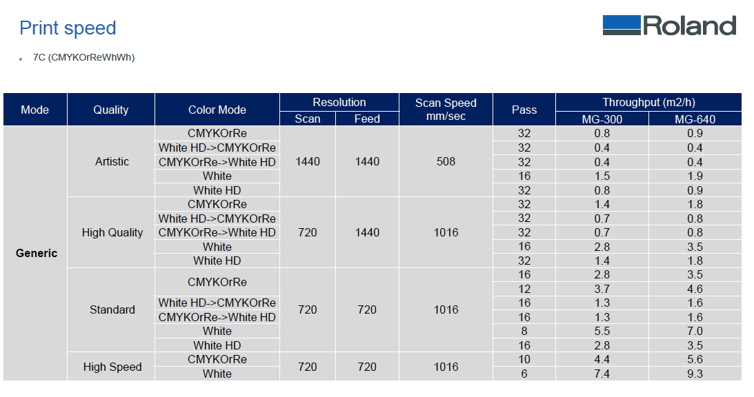

Heads are staggered, so the order that the heads are physically in determines whether you can print white over/under without the need to pullback the media.Surely the print order is set in the rip? We regularly print white on top of cmyk by choice.
Ah ok. Interesting. We are running an LG-640 with a single 8 color head.Heads are staggered, so the order that the heads are physically in determines whether you can print white over/under without the need to pullback the media.
Having them in the wrong order means halving the print speed as it has to feed the media back for the second pass.
