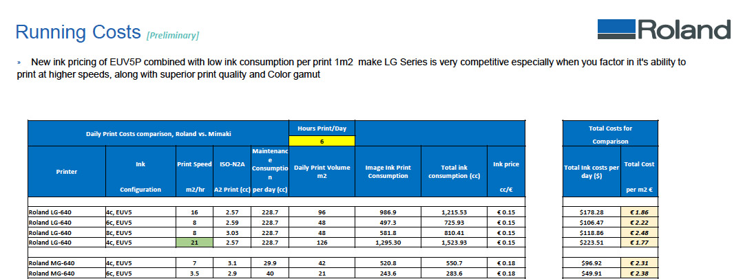

According to Roland themselves the "running costs" or the maintenance consumption per day of the Roland LG-640 is 5.7 to 7.6 times higher compared to the Roland MG-640. See below.

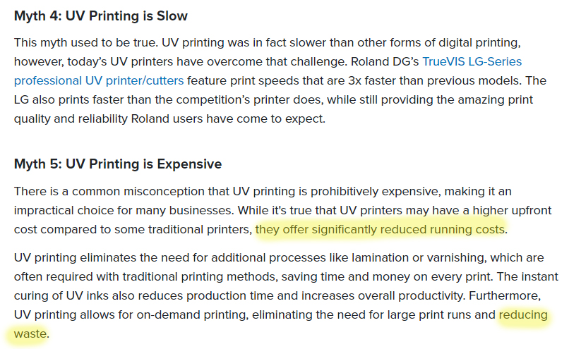

Btw Roland clearly states in its marketing, see below, that the LG should use less ink and create less waste, as also said by the dealer, but it clearly does not. Even according to their own information, I shared previously.
Debunking UV Printing Myths: Separating Fact from Fiction - July 13, 2023 - Ginny Mumm - https://www.rolanddga.com/blog/2023/07/13/uv-mythbusters
BVG
Wow....based on that if we print just over half a roll per week day our annual ink cost would be $61,000.
Cleaning alone with no printing would be $22,000 a year. That's absolutely insane. We've got a unit on order currently, but we'll be having a very frank discussion in the new year with Roland.
