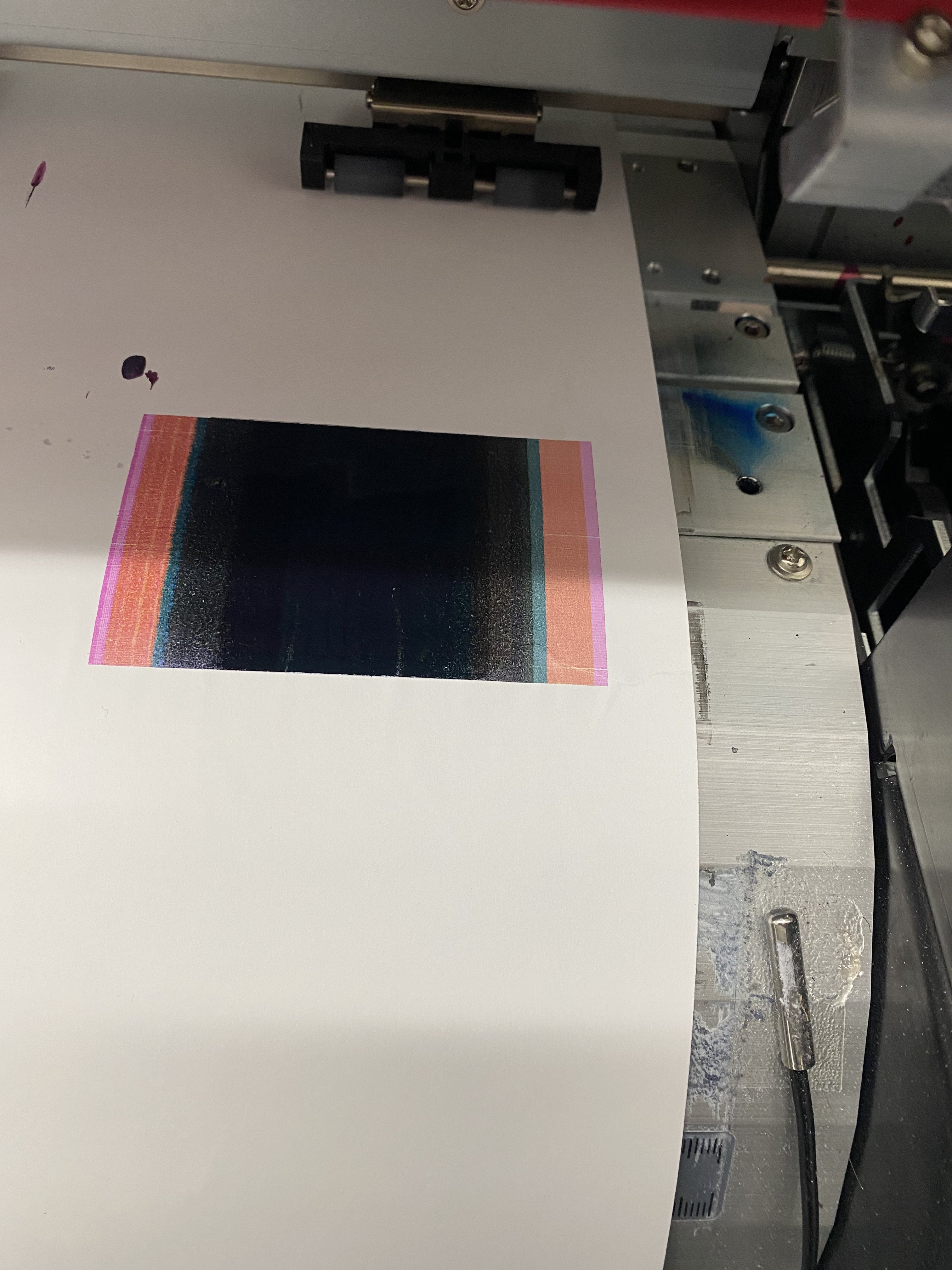

This morning you could see the test print.
It was ok the last week. Really don't understand the mistake.
I don't have error message, do you have any ideas ?

Check your head cables for damage, corrosion, or ink splatter. Something is shorting out and causing the head to malfunction. It could be the head itself but it's usually a cable somewhere that's not plugged in properly or is dirty.

Thank you for your help. I just clean & check the 4 cables on the head, still the same Problem. May be I have to check the "head board" ?

After many try.
I don't know why but sometimes there is ink in the captop (after a single cleaning it's ok).
I changed the linear encoder, still have some trouble but it's really weird, because when I print a file from Versaworks, it's ok except all the print Area is black (like the 1st Picture).
So I think it's the head print, but I want to be sure. A bad head print could create linear error ?
