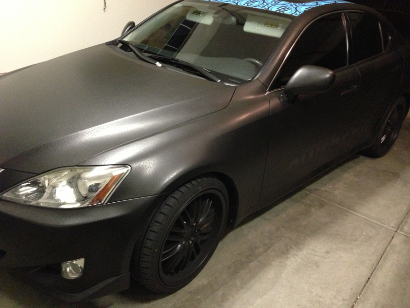

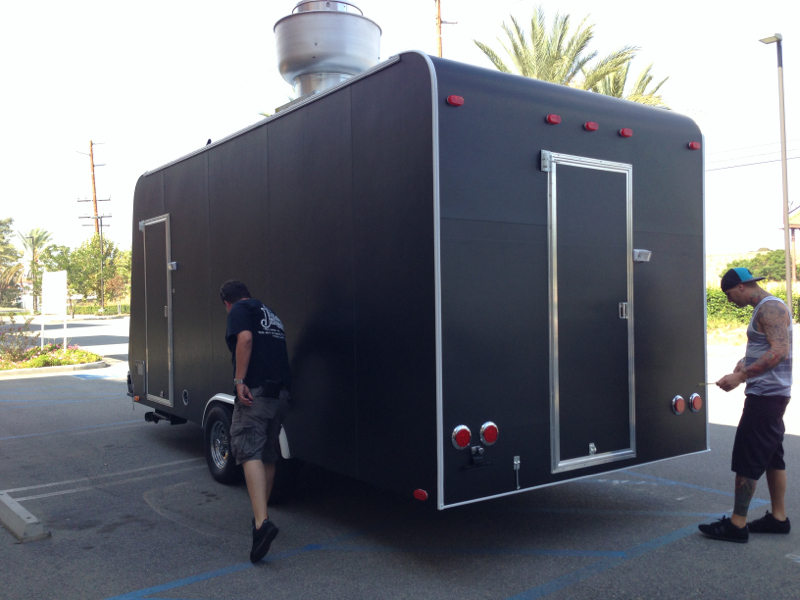

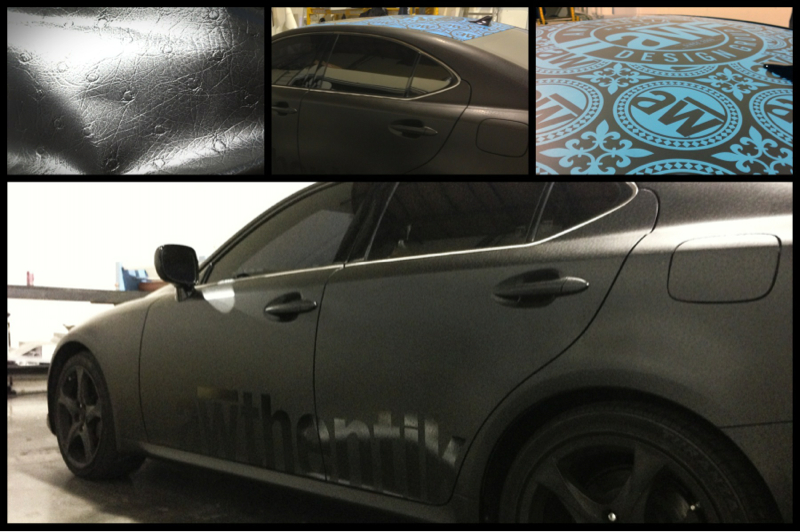

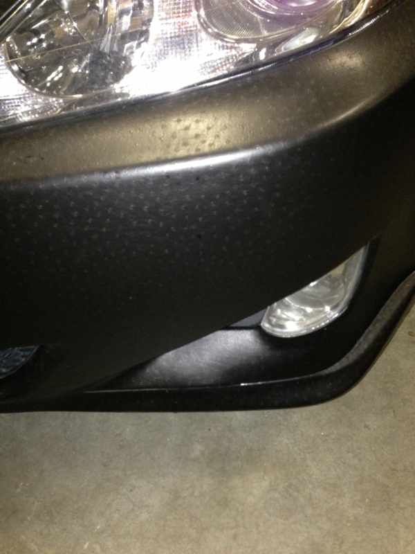

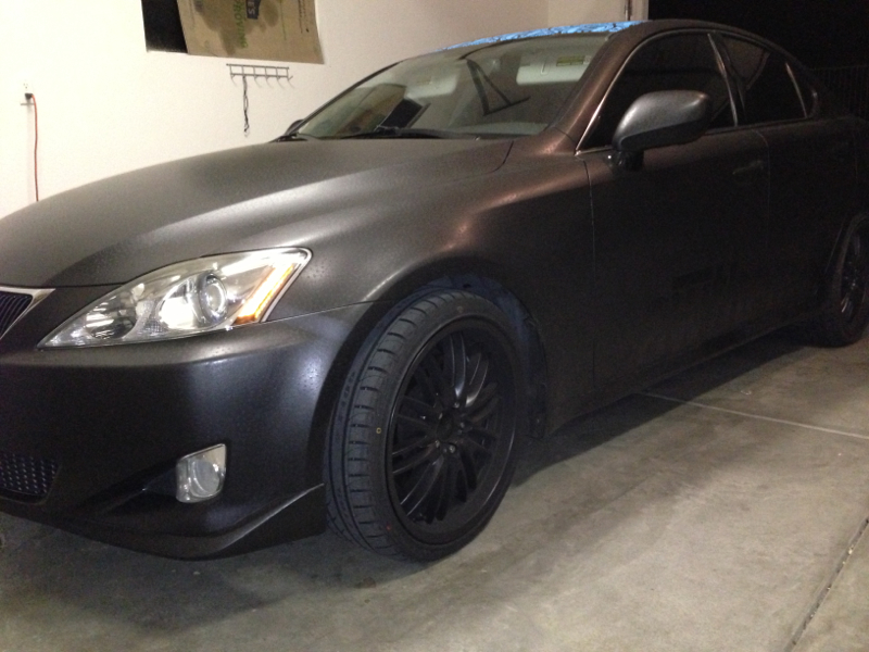

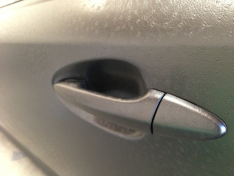

We used the black ostrich on a trailer and our Lexus. Installs really well and feels amazing. Can't say how it will be in 2 years cause we change ours yearly... But I got a good feeling from it. Keep in mind this is only the textured vinyl.. I've never touched thier other vinyls. ( prefer Oracal )
