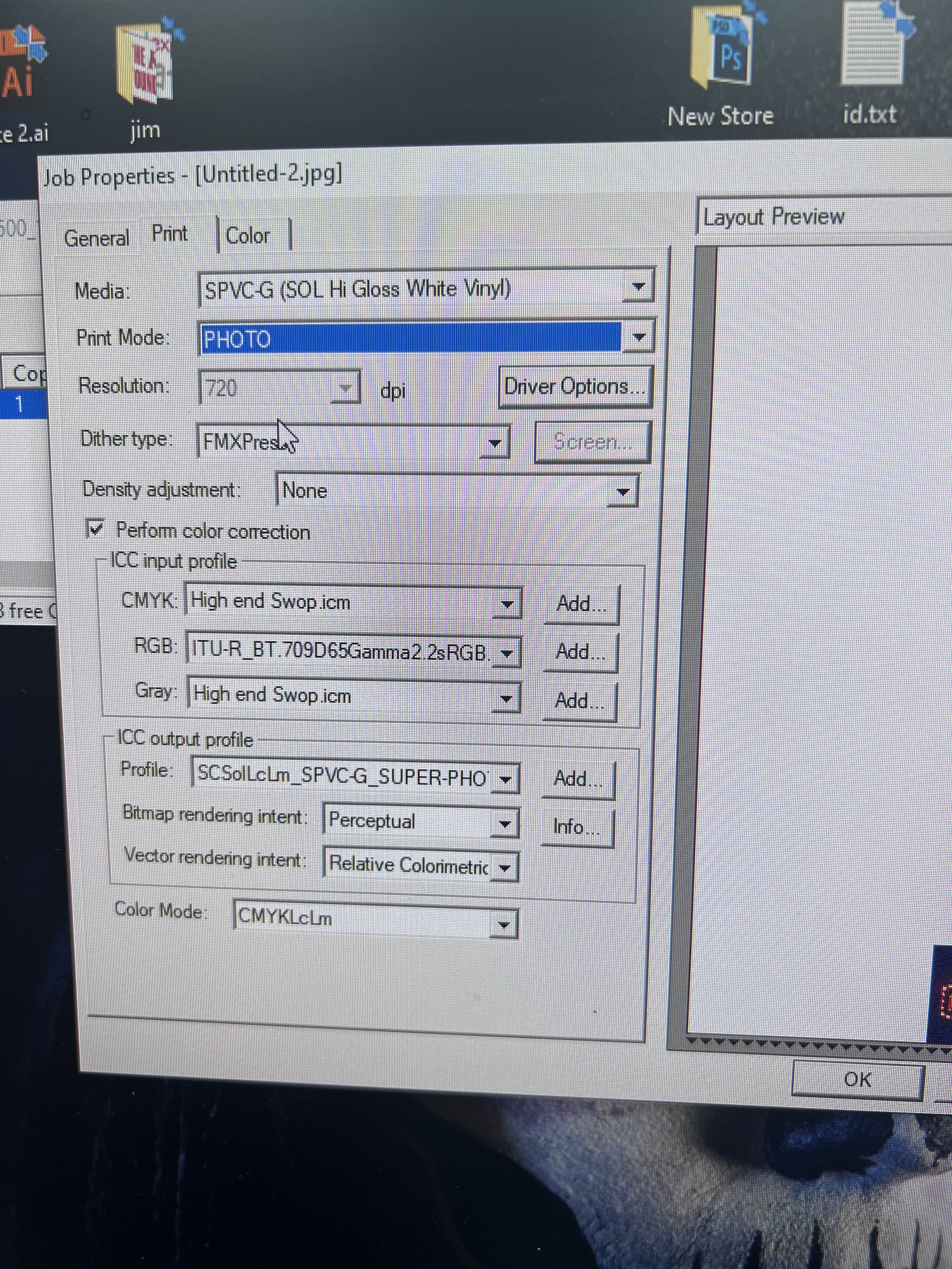

If you print without color management, you have no ink limit, no linearisation and no ICC. It will be very difficult without at least ink limits.
In Flexi, you have different possibilities to set the dithering for printing, some are more grainy than others. But grainy prints could also be a result of misaligned heads or bad bi-directional adjustment.

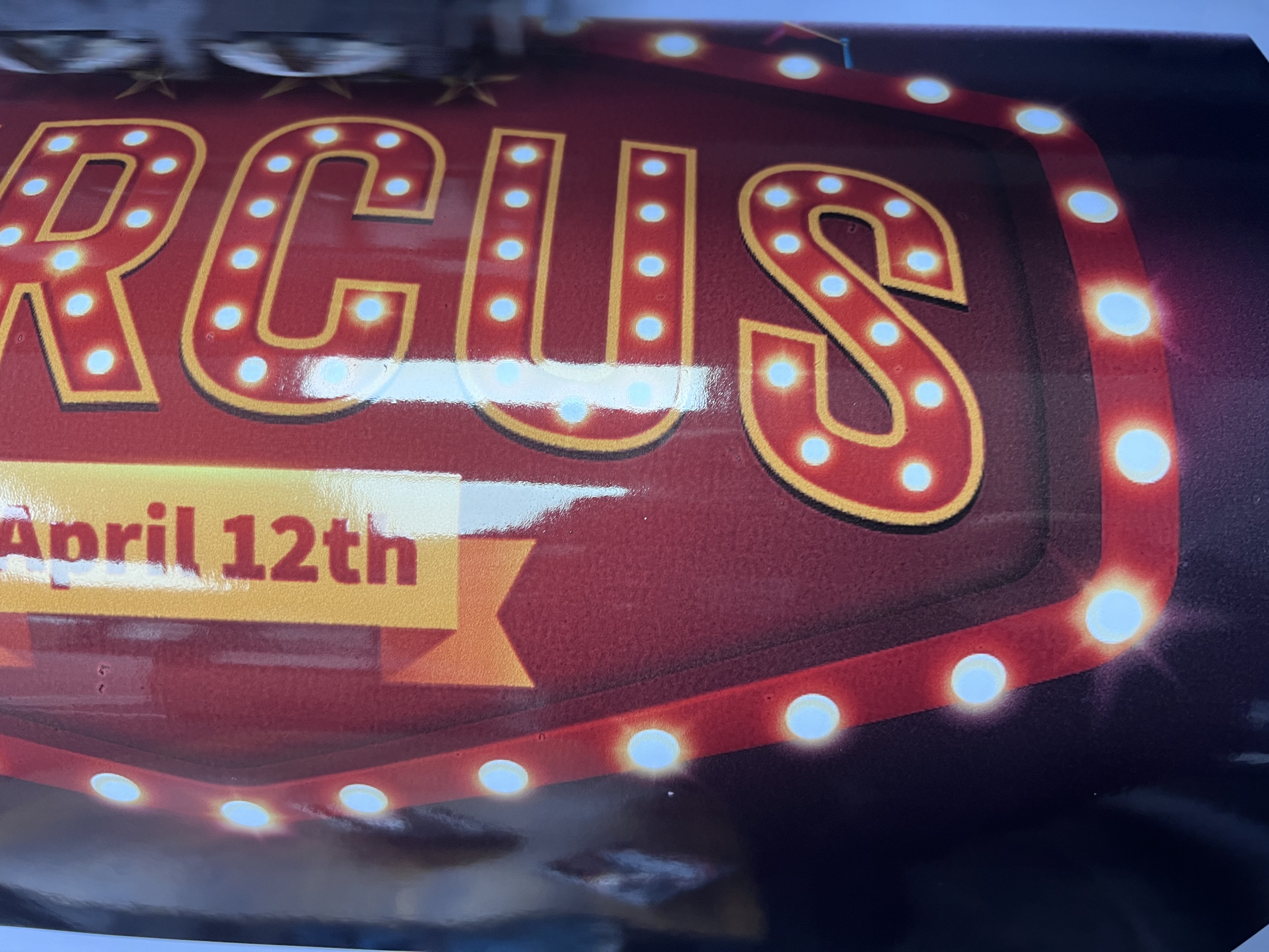

Here we go

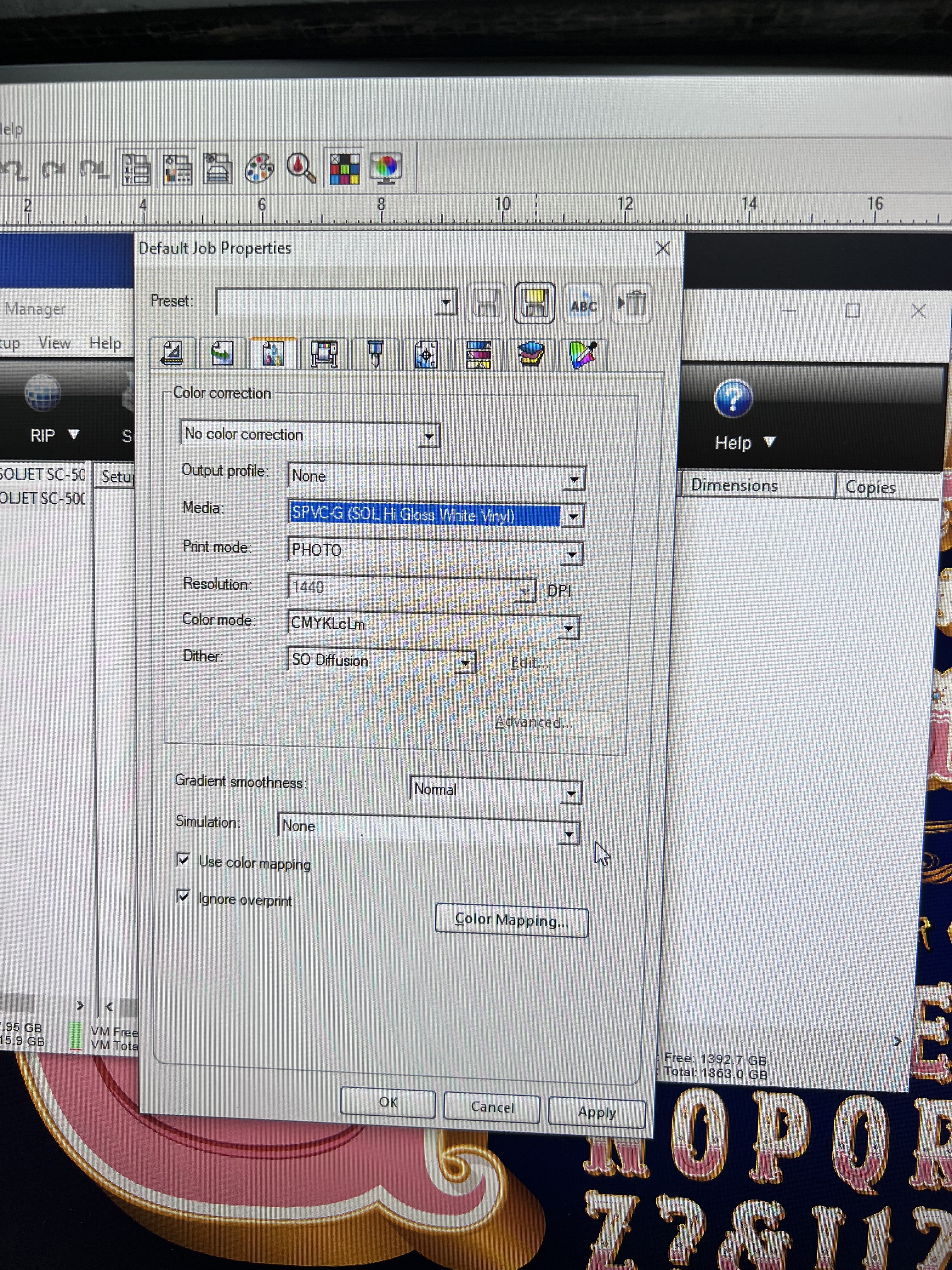

Terry01

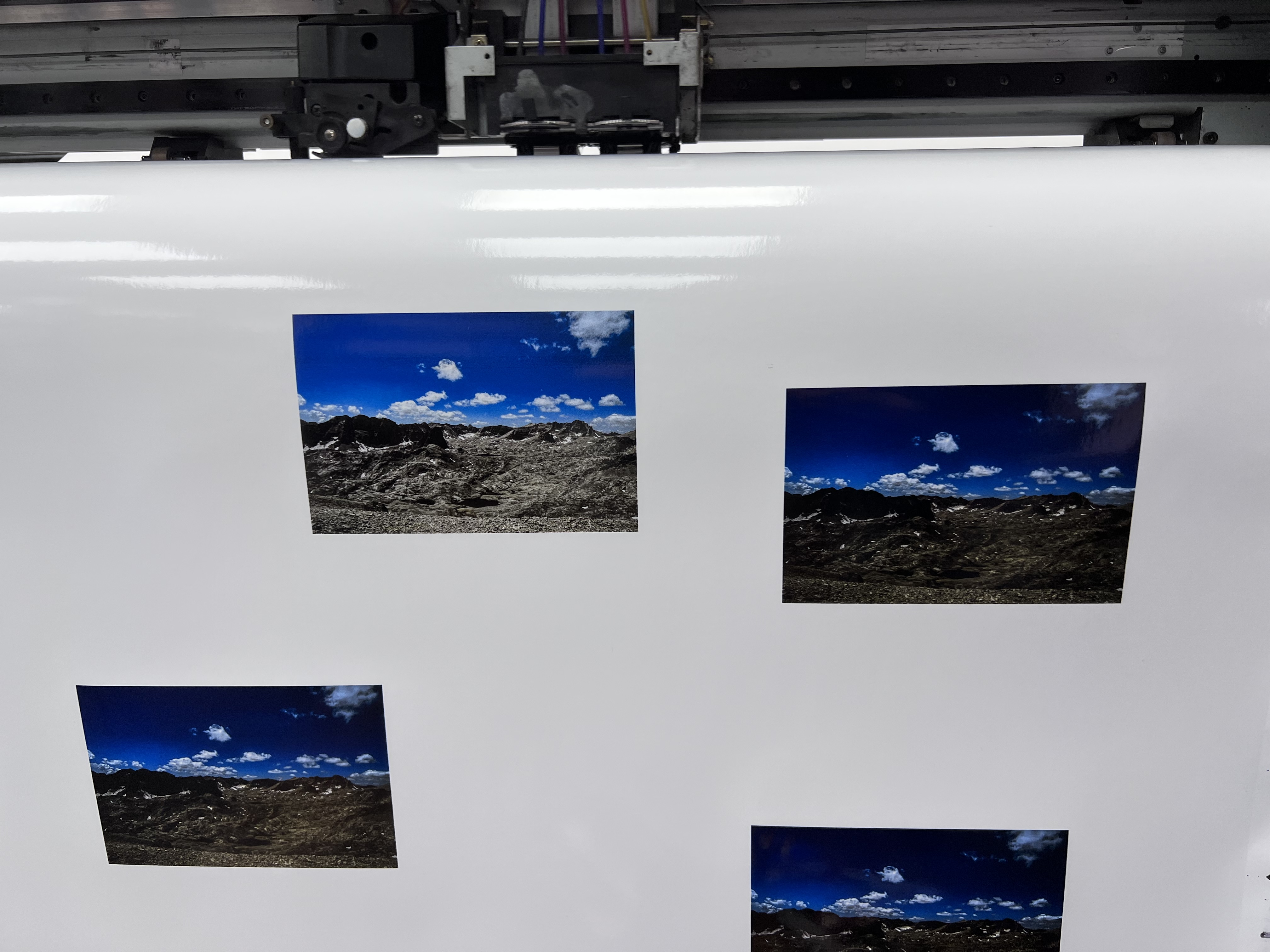

Now go to production manager>setup> default job properties>turn off color correction>go across to color adjustment> move adjuster to 45% whilst in all colors> apply
Also turn heat up higher..print looks to be pooling slightly and print it again

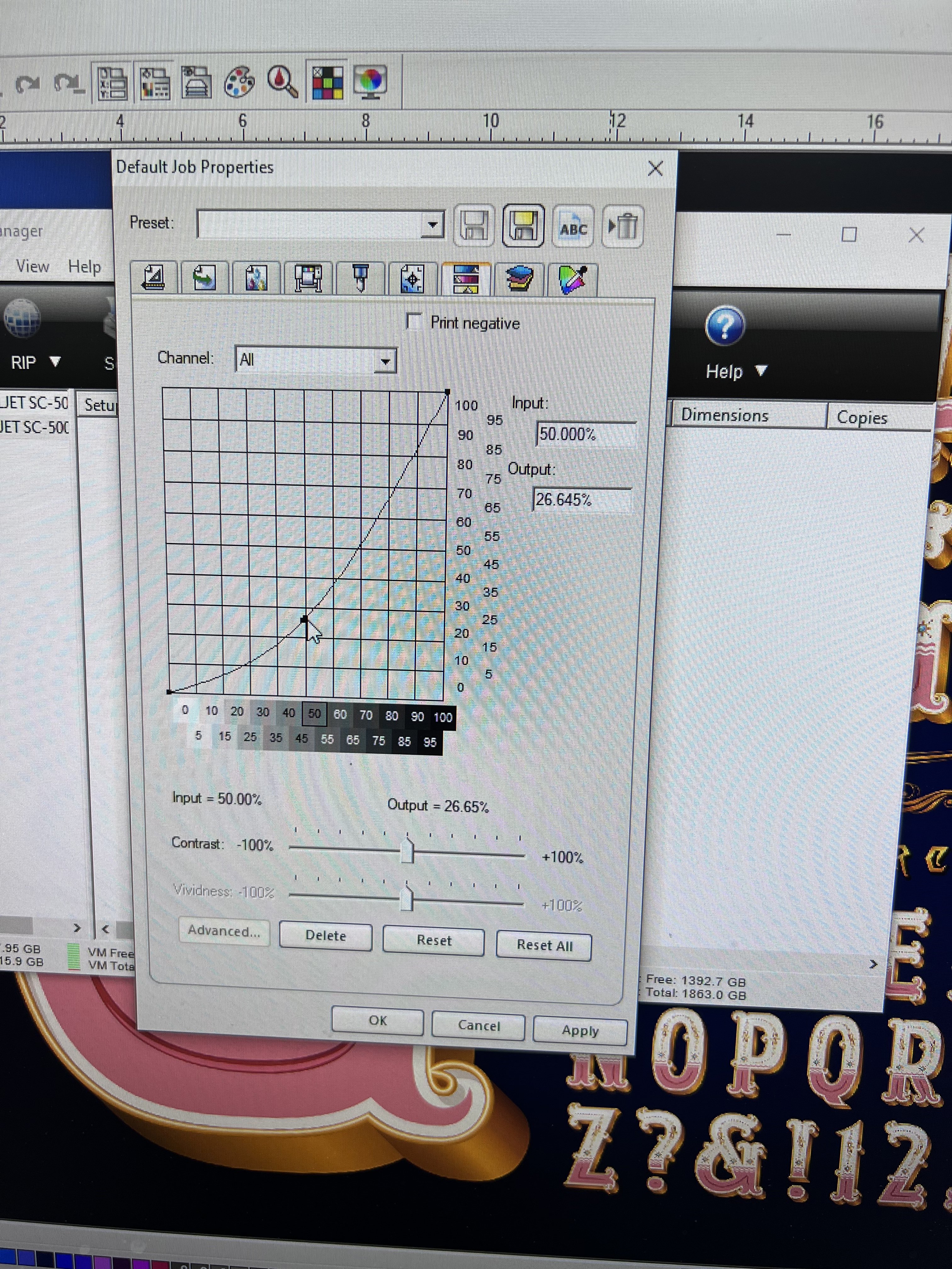

Hi Terri definitely some progress made. I made output to 45 and then kept going lower to get the pictures lighter the top left pic is at 25% output. The rest were 35-45%. Do you think I am on the right path? Here is what my settings look like too all the input is around 50% is this correct?
Terry01

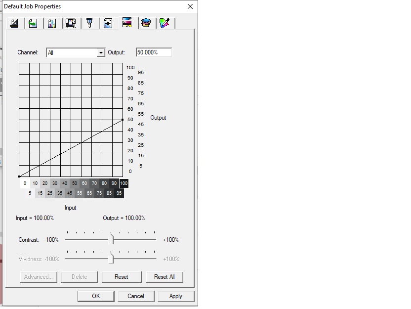

Reset what you have done.. Then just shift the 100% marker down to 50%, see what it looks like and then possibly work your way up or down from there.
Also see if you can find that image I posted a link for. It is one of the best to work with

Terry01
By moving it 50% for a start, lets you see how much of a change it makes. You can then start working out where you need to be from there

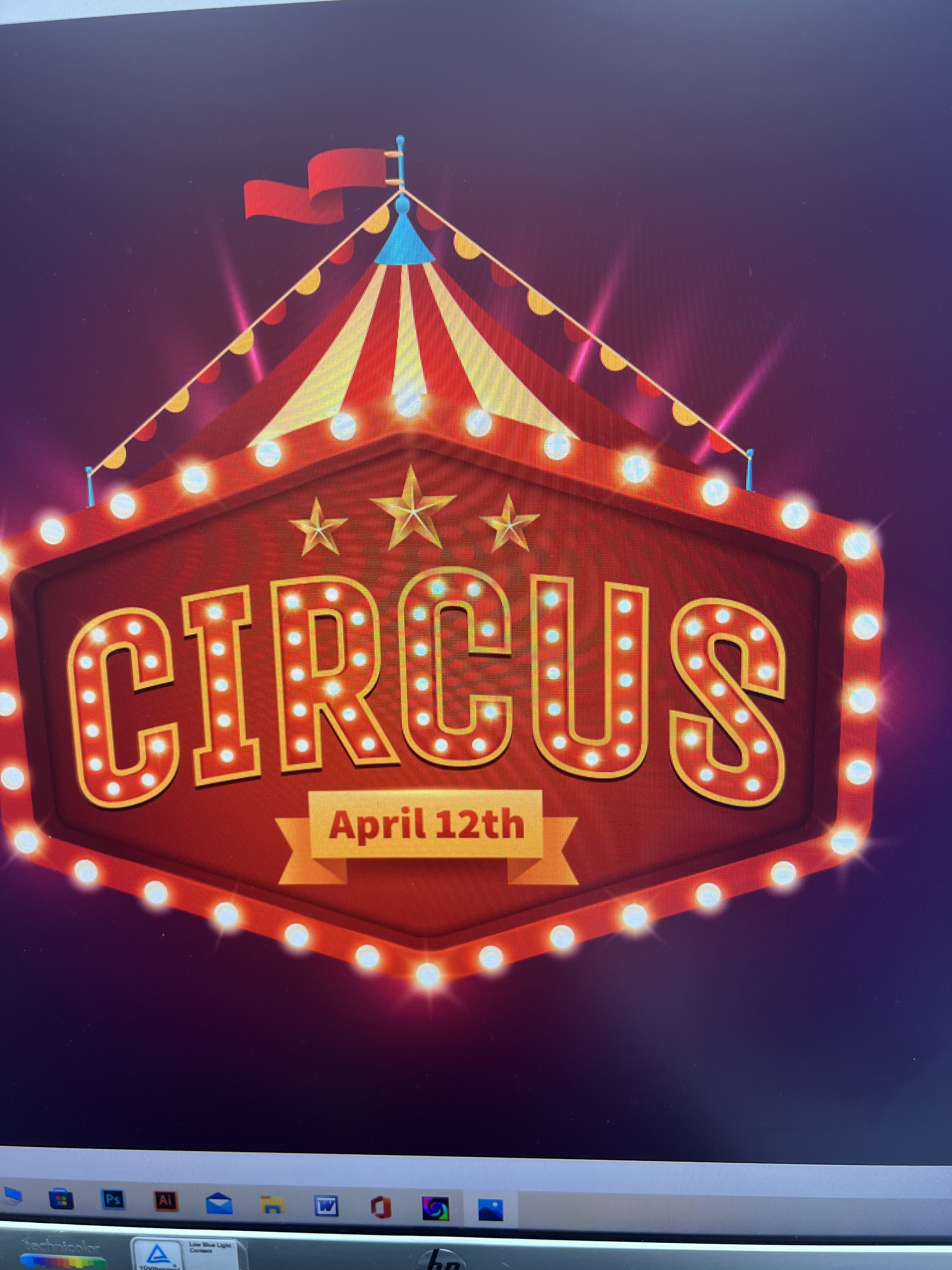

That's the image, and do read the notes, they help you see what you are looking at. Also quite useful to check that your monitor isn't showing you false promises.

Terry I moved the top point down to around 50. The print is good enough for now I think it’s as good as it gets.
The test image print was ok, could maybe do a little bit more vibrancy but I am happy how it is.
