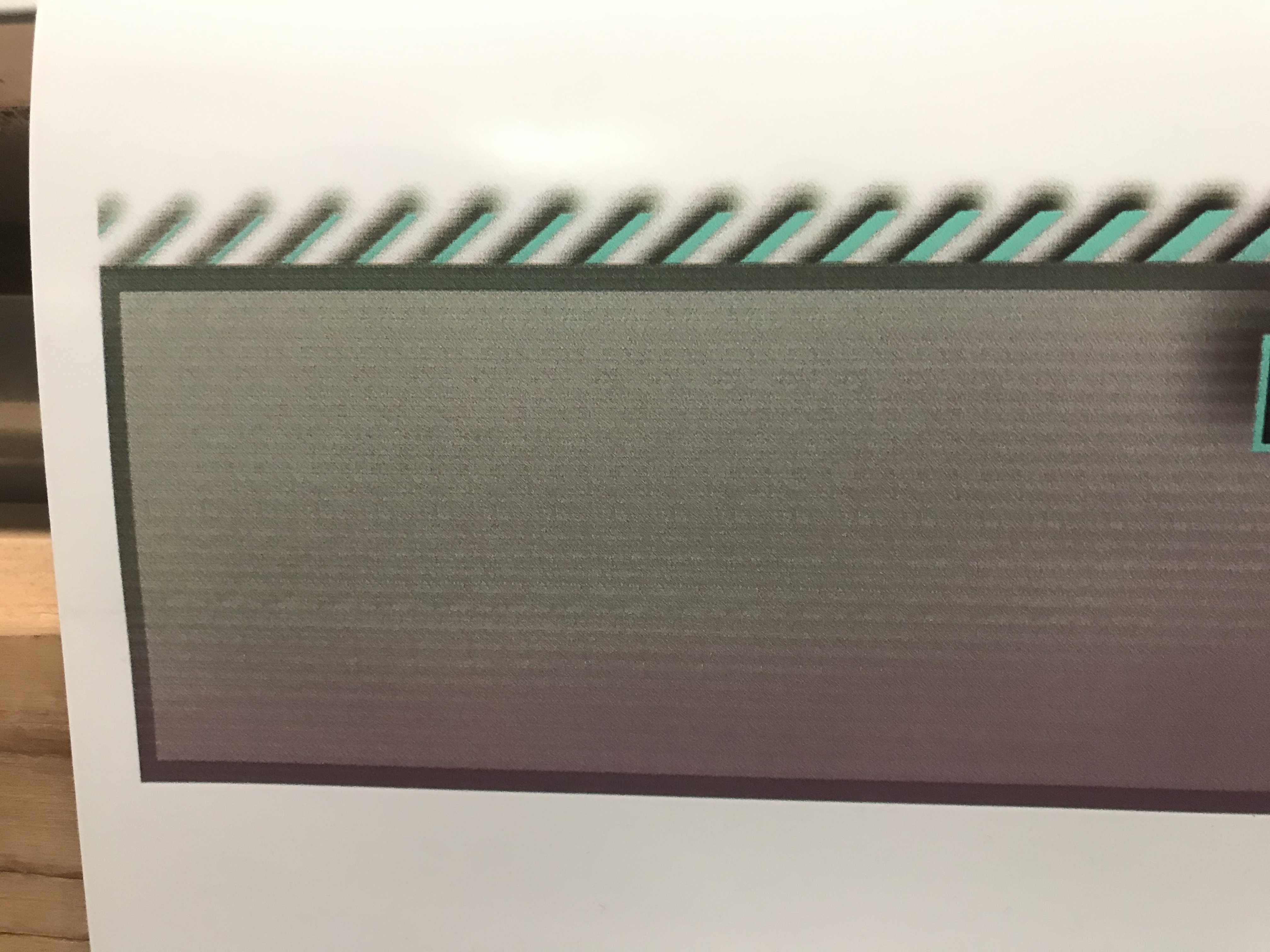

Ok finally back up and printing but I’m still having the same issue with the magenta dropping out at the left side of the print? Replaced dampers, wipers, scraper and no luck? Anyone know what I should try next?
