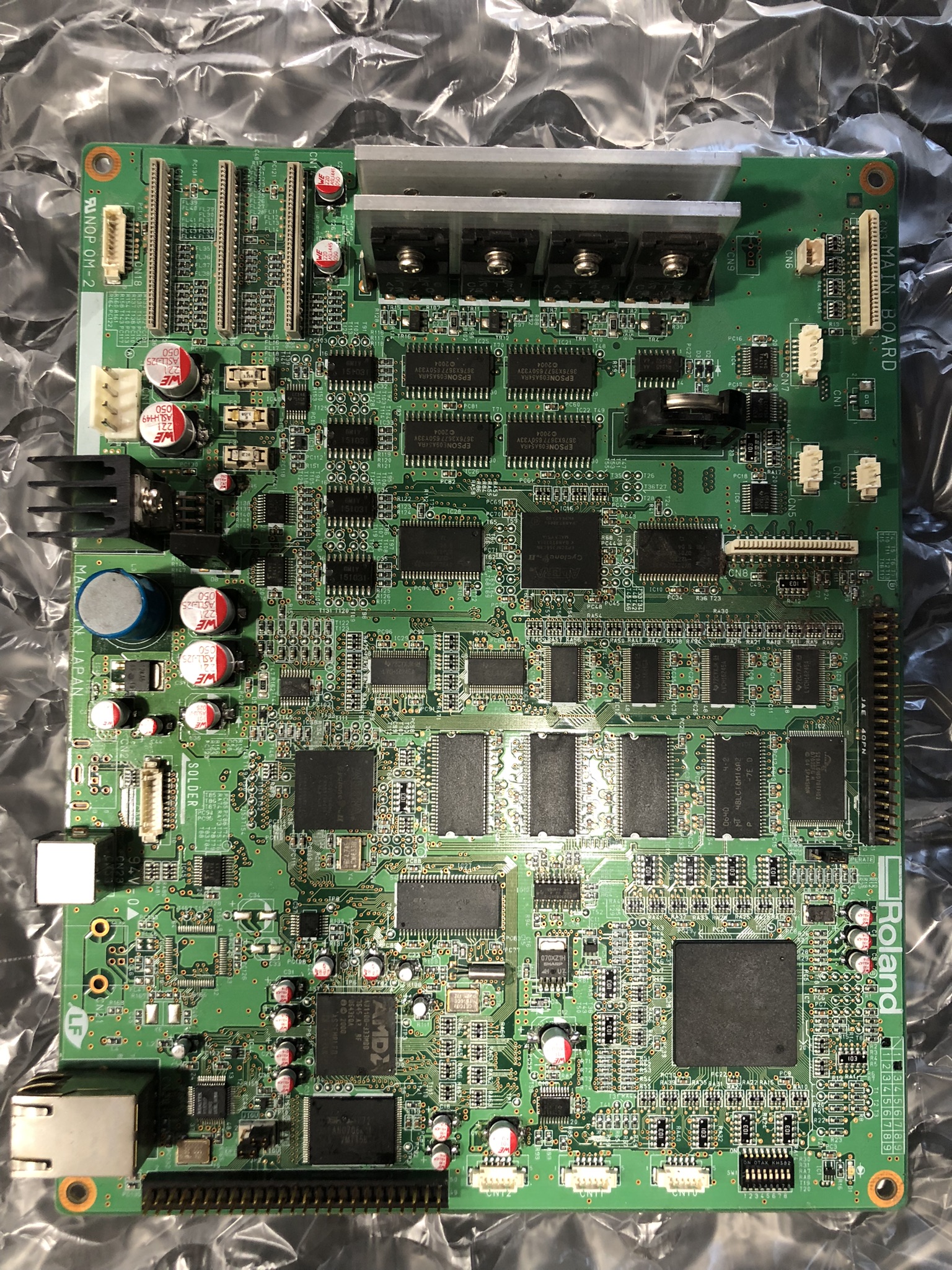

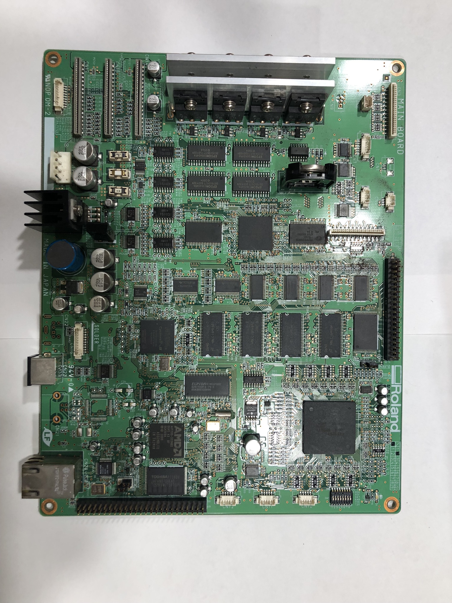

I found these guys on eBay but they also have a website. They were fast to repair. Shipped out my board and it was back within ten days. You can see by the images that they replaced several components. They also warranty for 2 years.
Brooks Circuit Specialists
683 Walton Ave
Mt Laurel, NJ 08054
Jack
