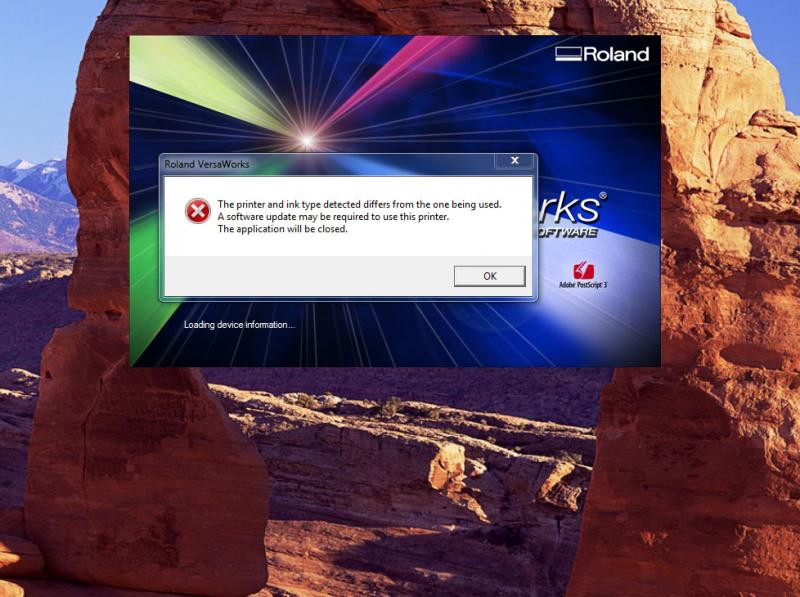

    Anyone know how solve the problem of "printer and ink type used differs from the one being used" when launching Versaworks. I called Roland, they could not solve it. I was given a solution of uninstalling and reinstalling VW by Roland tech support. When uninstalling all the VW folders were deleted including the ones in the trash can. It worked when reinstalled, but each time Win 7 was shut down and relaunched, the same problem started. To get over it I have to uninstall and reinstall. The attachment if it did attach shows the error from VW.
    Currently I am running Win 7 pro in virtual mode using Parallels. I am using Parallels for about a year and no problems. It is up to date so is Win 7.

    It still did not work. When verifying the printer, it puts in the ink type which is in the Roland printer SP-300v. Under Edit then Preferences there is no tab to set the ink type. My VW is 4.6.1
    Anymore suggestions?

    Thanks a bunch. Did the initialize after which it asked me if I want to install the Printer Driver. It failed on installing the Printer Driver, but VW launched OK. After a while I will see if get the same error when Win 7 is shut down and rebooted.
