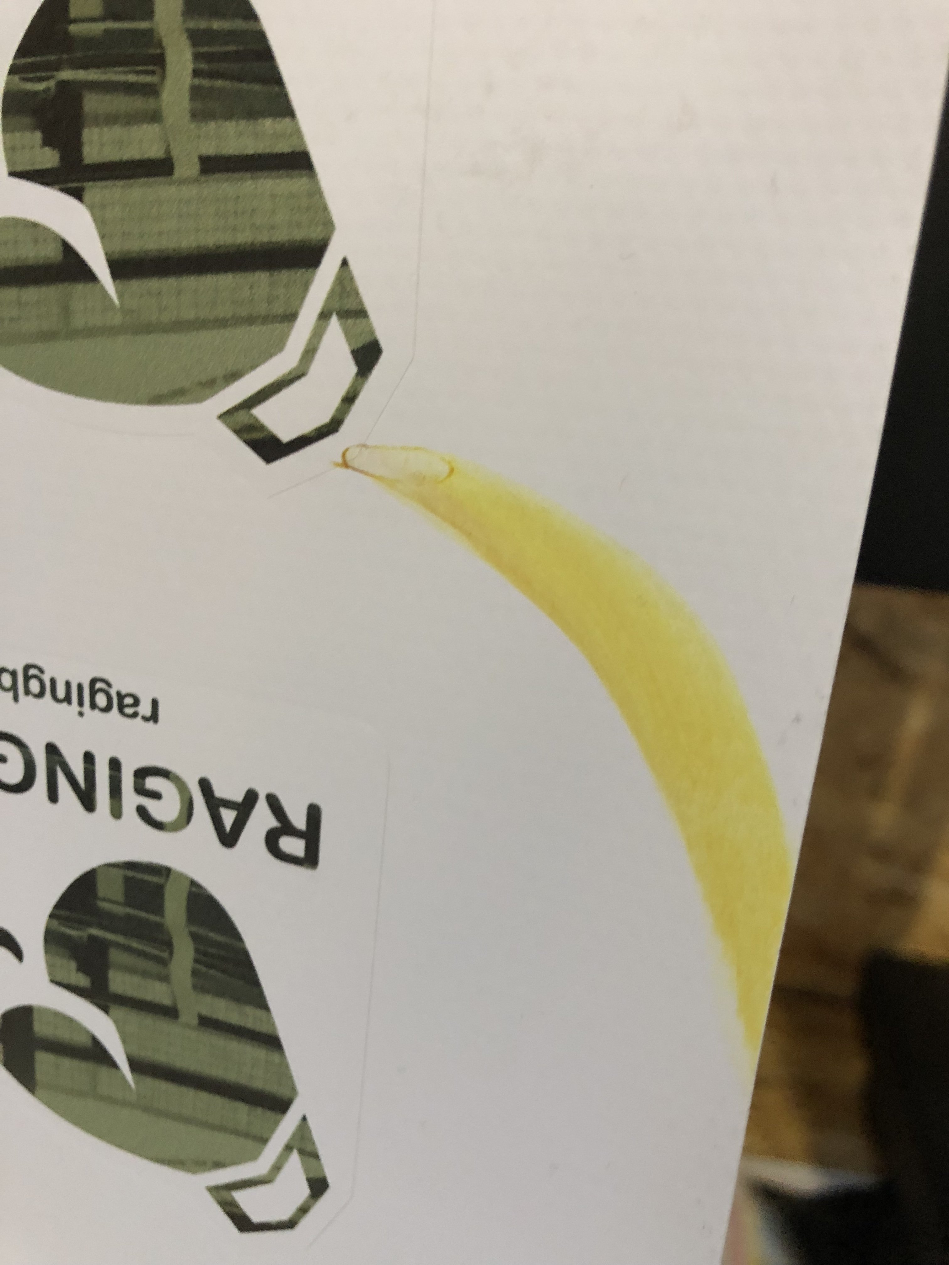

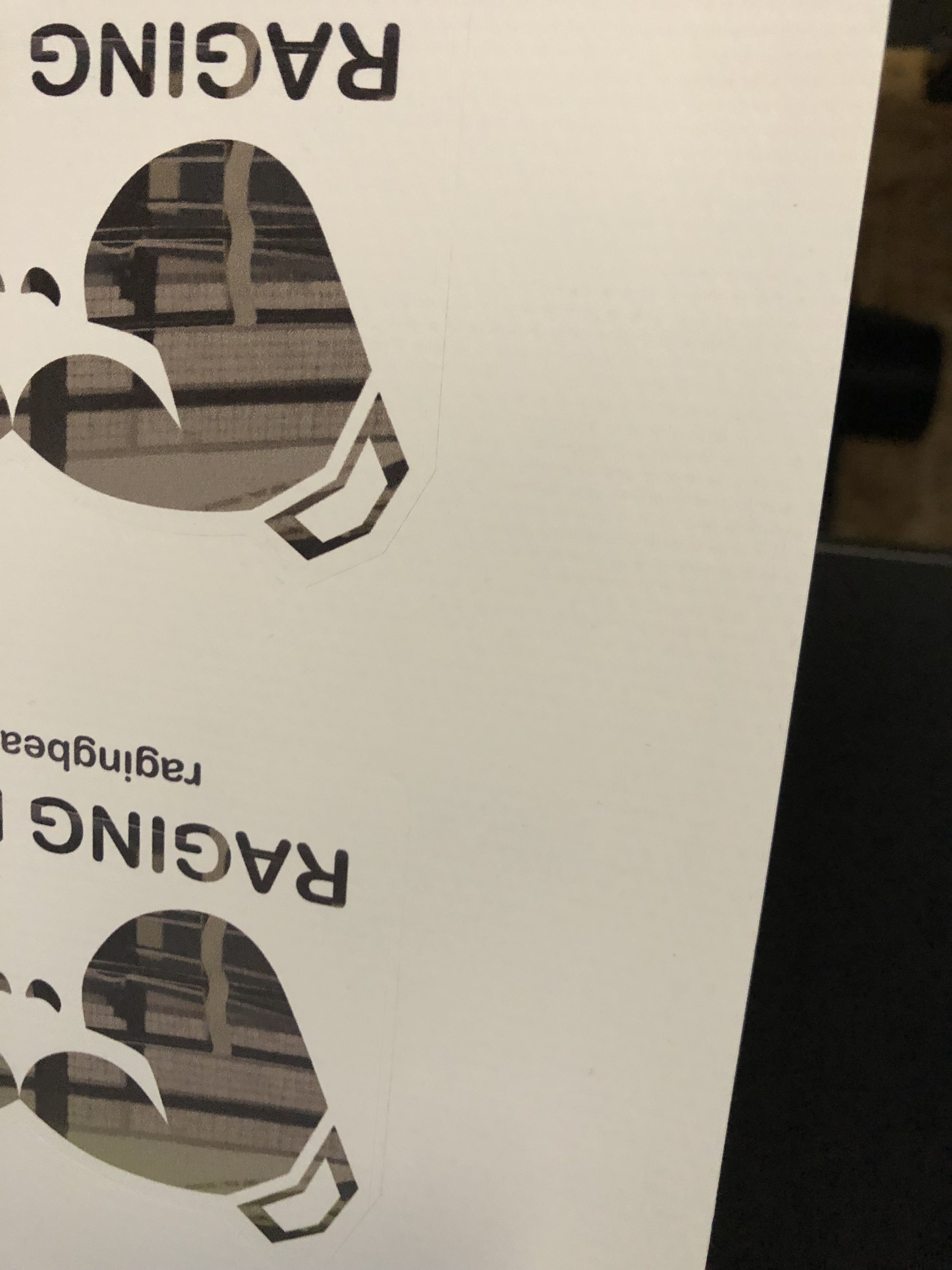

    Hello,
    I have a Roland VS420, each time I get to use it, it has excess Yellow in the print and often a blob of Yellow drops onto the print.
    No problems after it’s been in use and ink gets used.
    Any ideas why I keep getting this?
    Please see pictures attached.
    Thank you.

    Thank you for your advice.
    It is new head and Capping fitted two weeks ago. I have just lowered to Capping and so far so good.
    Fingers crossed. I will see what happens tomorrow...

    You want to make sure the printhead itself is periodically cleaned like once a week minimum. There might be dust gathering around the head and the more you print, the ink will drip onto the material. Clean with swabs and cleaning solution.

    Yes, I am about to set my reminder to clean every Sunday.
