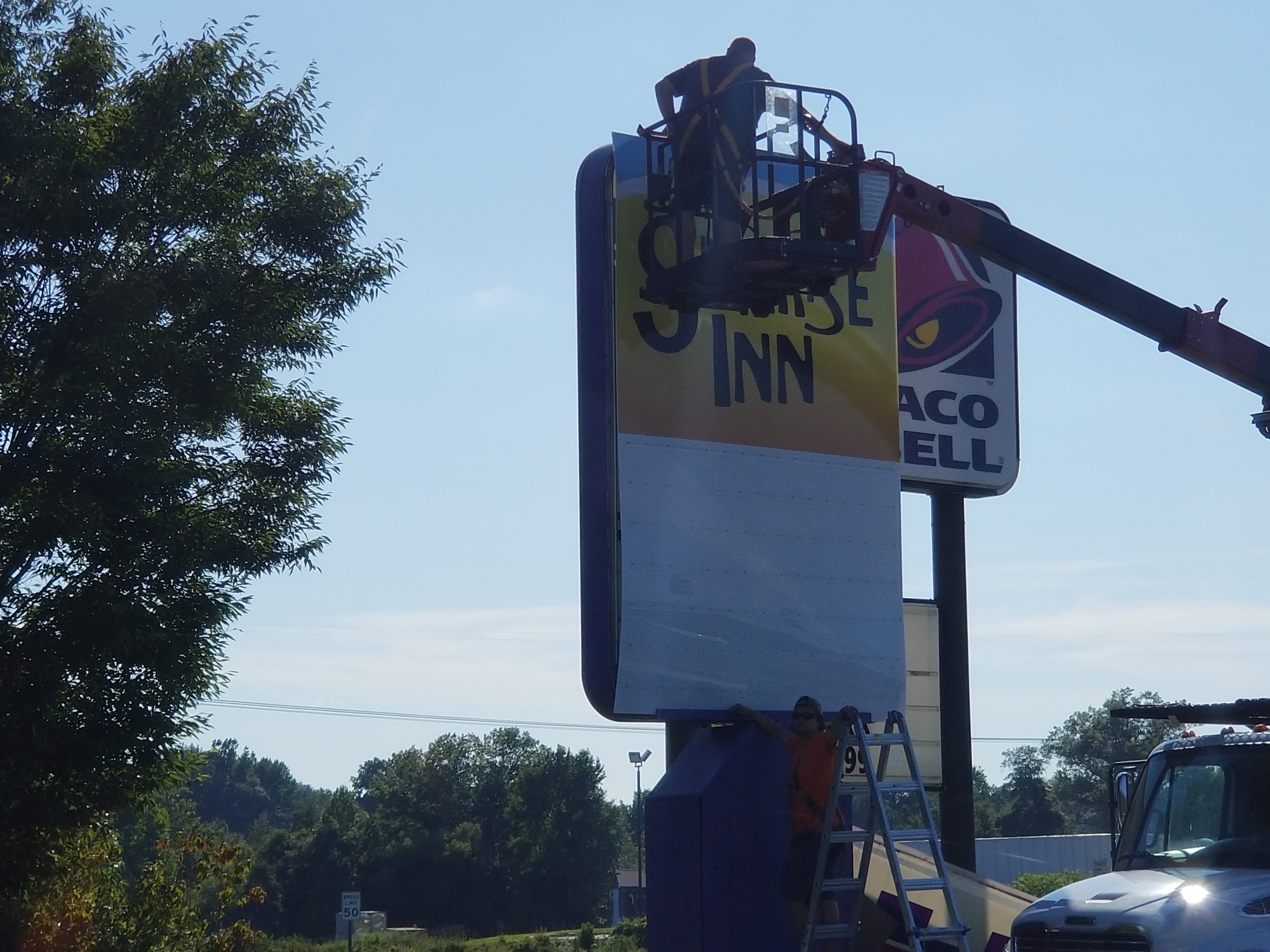

On a related note, I'm guessing this photo I took of a local company recently, used a jig saw on site for these panels to fit too? Lol the odds of me seeing this huh
Always keep a good jigsaw or circular saw on the truck when doing these signs... Comes in handy more often then not. Sometimes I will measure the sign face only to discover that the frame "shrinks" or bends in somewhere down the line and I have to trim a panel. Remember, you can always cut a panel smaller easier then making it bigger.
Looks like the guys in your photo used fasteners on their zip tracks too.
