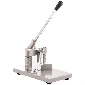

I guess the big question; how many are you doing, and how pretty does it have to be? From your pic it appears they are viewed close-up, and can be touched, so high quality is necessary....but you want to avoid having to file and sand and cleanup every corner .....for hours!
Although I've used a lot of corner rounders, most of the ones suggested do NOT cut 1" radius.
The heavy duty version of the Lassco-wizer, the CR-60 will do it....the smaller ones have a plastic deck and mine all eventually cracked when nipping heavier materials!
Stacking multiples is obviously the smart way to do it, as long as the edge finish doesn't suffer. I find the bottom skin often leaves a sharp burr that has to be cleaned up. The Expert tools dies here are handy, but not cheap or able to do more than a few pieces at a time. ( Ignore the prices ....if you're south of the border!) :)

This is the exact one we use. 3mm or 6mm ACM, magnets, PVC, etc. The thing is built out of flimsy metal, and over the years it has gotten a little jankey, but it functions reliably.

They're kind of pricey for what they are. We have one of these for larger radius, it will handle 080 but is a little slow compared to the electric rounder we have.

That thing looks pretty serious. I want one.
