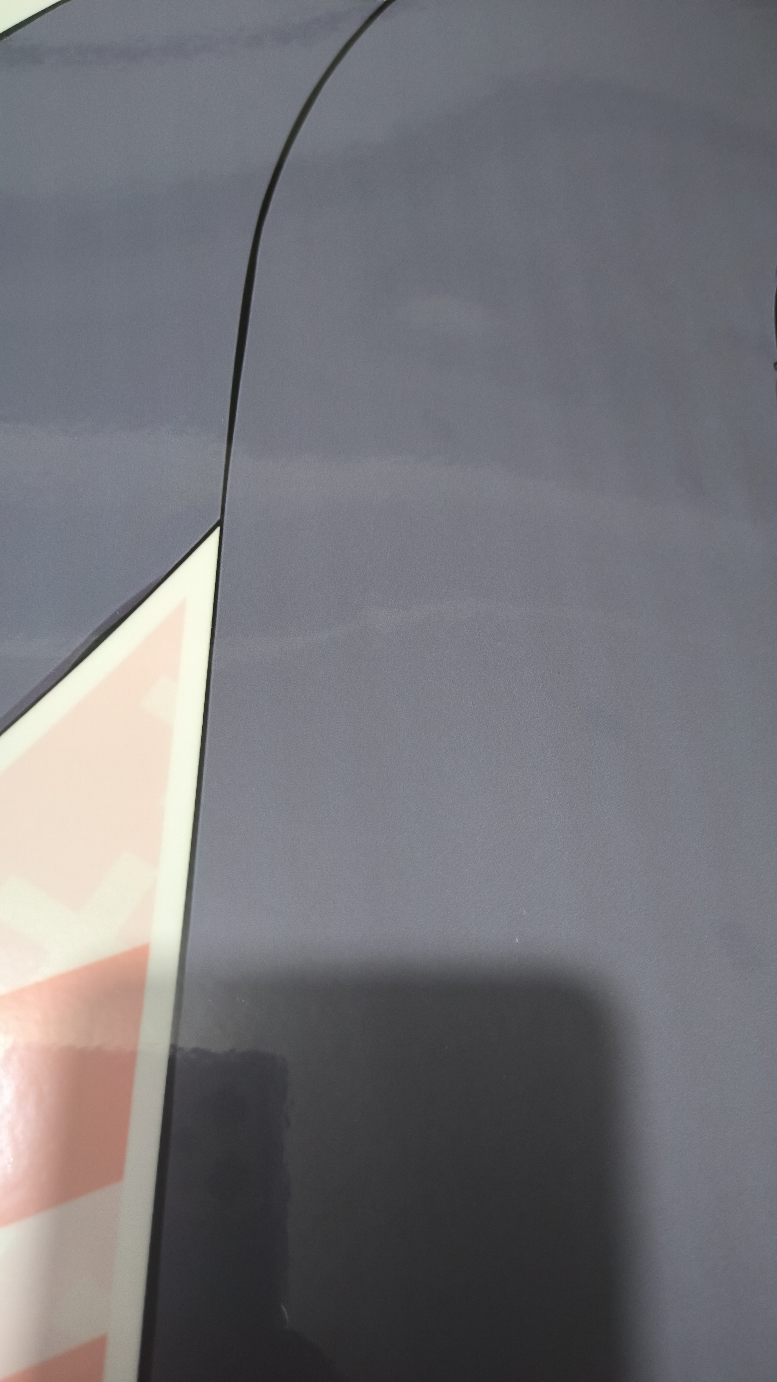

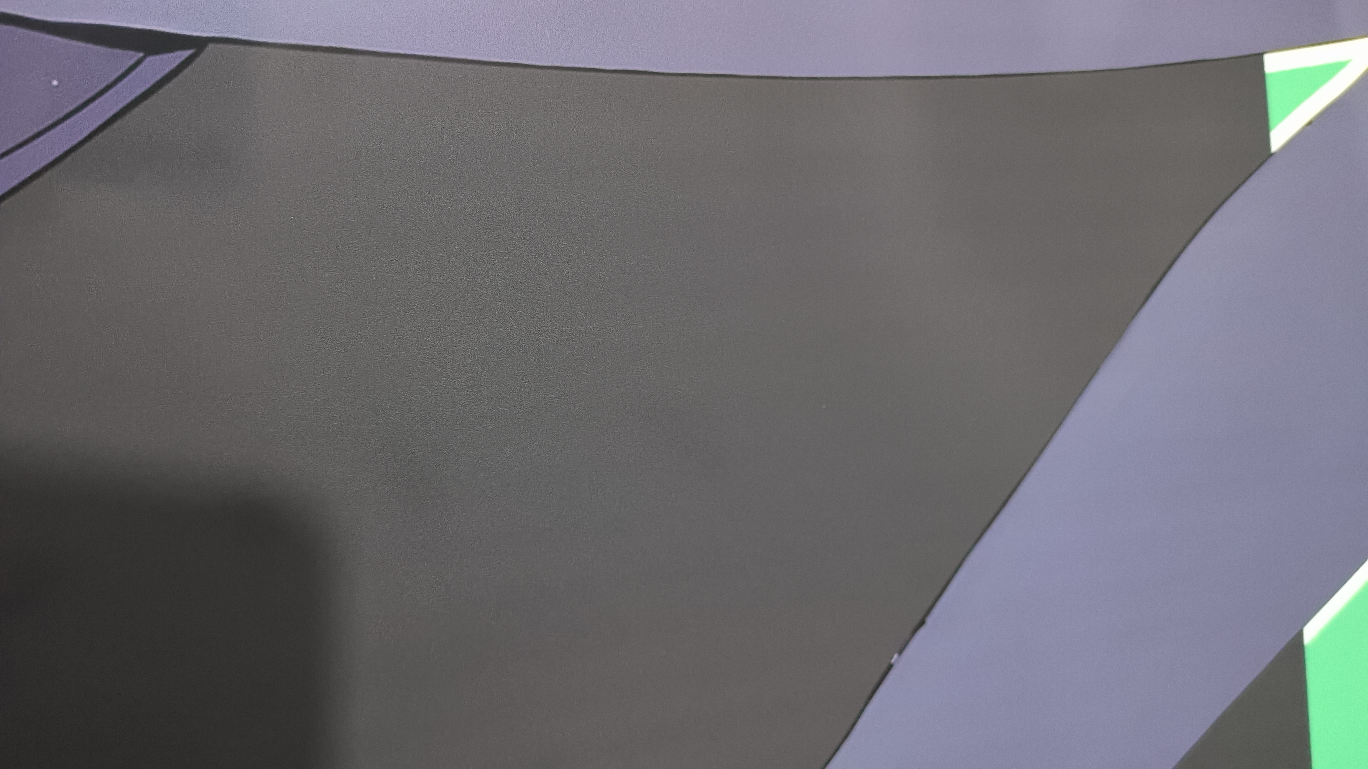

tudouqiezi
我的新 80600 也遇到同样的问题。
Jeppe.Nielsen
I got a demo S60600 in Jan 2022. Showed up with 1 head not working. Head got replaced and printer worked amazing for 2 months. In the middle of a job it started banding. Canceled the print ran a nozzle check and a handful of nozzles missing. Clean, clean, good nozzle check. Started printing and finished the job. Then it kept happening job after job after job. This was at 8 pass on avery 1105. Nozzle drop out randomly. Also when printing 6 pass on 3m 40c I get What Epson is calling "lawn mower banding" light and dark banding.
Decision one came out and replaced heads. Did not fix the issue
Epson Tech came out. They could not figure out what the issues are. They replace heads again, caps, pumps, dampers, lines pretty much everything in the machine they replaced over 5 months. They think it is Onyx 21 causing the banding issues.
Last week they finally sent a new S60600 printer and Epson tech installed the machine. First print on 3m40c 6 pass banding. Next print on avery 1105 8 pass nozzle drop out 15 feet into print. Next print 2 feet. Once again Epson has no idea what the issues are.
Epson is telling me that banding on 6 pass is normal
Epson is telling me that printing solid colors on 8pass is to high demand for the printer and that it is causing nozzle drop out.
Epson is sending another tech next week to start replacing parts on the new printer
Even though they say nothing is wrong with the printer.
Adjustments have been made auto and manual
Epson tech printed test prints in service mode 6 pass with the banding and said that is normal
Profiles are from Epson Dashboard.
Epson is saying the issues are from Onyx or my profiles.
Printer is in temp controlled room 45% humidity and 78 Degrees
Any help or suggestions
