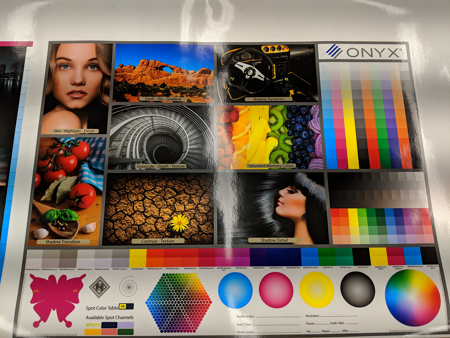

What does your basic Onyx control image look like printed on any material? At least one ONYX Quality Evaluation.pdf should be found in your Onyx folder(s.) That's a good place to start. Can you upload a photo of the result?
I'm guessing you're overlooking a basic setting, such as Spot Colors ON, etc.

It's definitely printing white. Just not as much as I need. I'm sure it's possible the printer+software combo can't put down that much white the way I need it to. I'm basically getting 2 layers of white (I think), when I need about 4. On our rolands I would have set it to print white, let it dry, and then suck it back in and print again, but I don't believe that's an option on the epson.

Have you visited this video from Onyx, "Application Tools: Using the ONYX Spot Layer tools for white and specialty inks"?
Your machine will lay down all the white you're looking for in a single pass. The ink should practically dry at the platen and only cure at the next heater. Your setting of 400% ink limit is telling, and incorrect.
Be sure to tackle your workflow and settings critically. You might consider trouble shooting with your dealer or Onyx.
