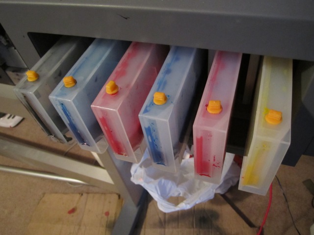

I went through each damper and drew ink all the way through, keeping the suction on it for a a minute or so after the ink came all the way through the line and into the damper. Cleaned the end, make sure the nuts & O-Rings were tight and re-installed the dampers.

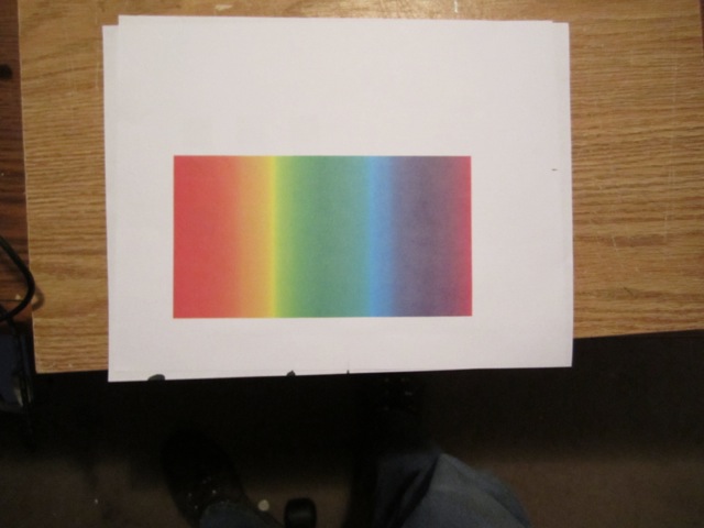

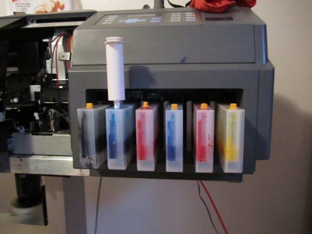

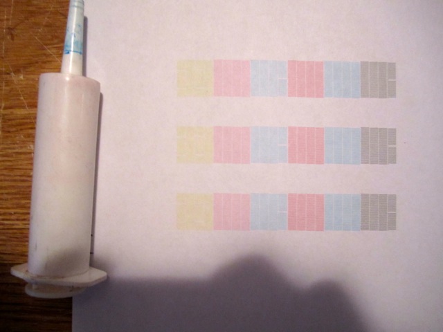

I then went through a few cleaning cycles and applied a slight bit of positive air pressure directly into the ink cartridge through the refill opening with a large Plastic syringe that I had. This application of pressure during the cleaning cycle(s) appears to have done the trick. I finally saw the "brown" colored ink mix coming through both waste discharge lines out of the capping station. My Test prints are now coming out almost 100% and I fired off a gradient spectrum printout. below ore some photos of the setup I used to finally properly prime & clear the heads.
I will now go through and do a thorough cleaning of the whole printhead assembly as is outlined in the owners manual.
