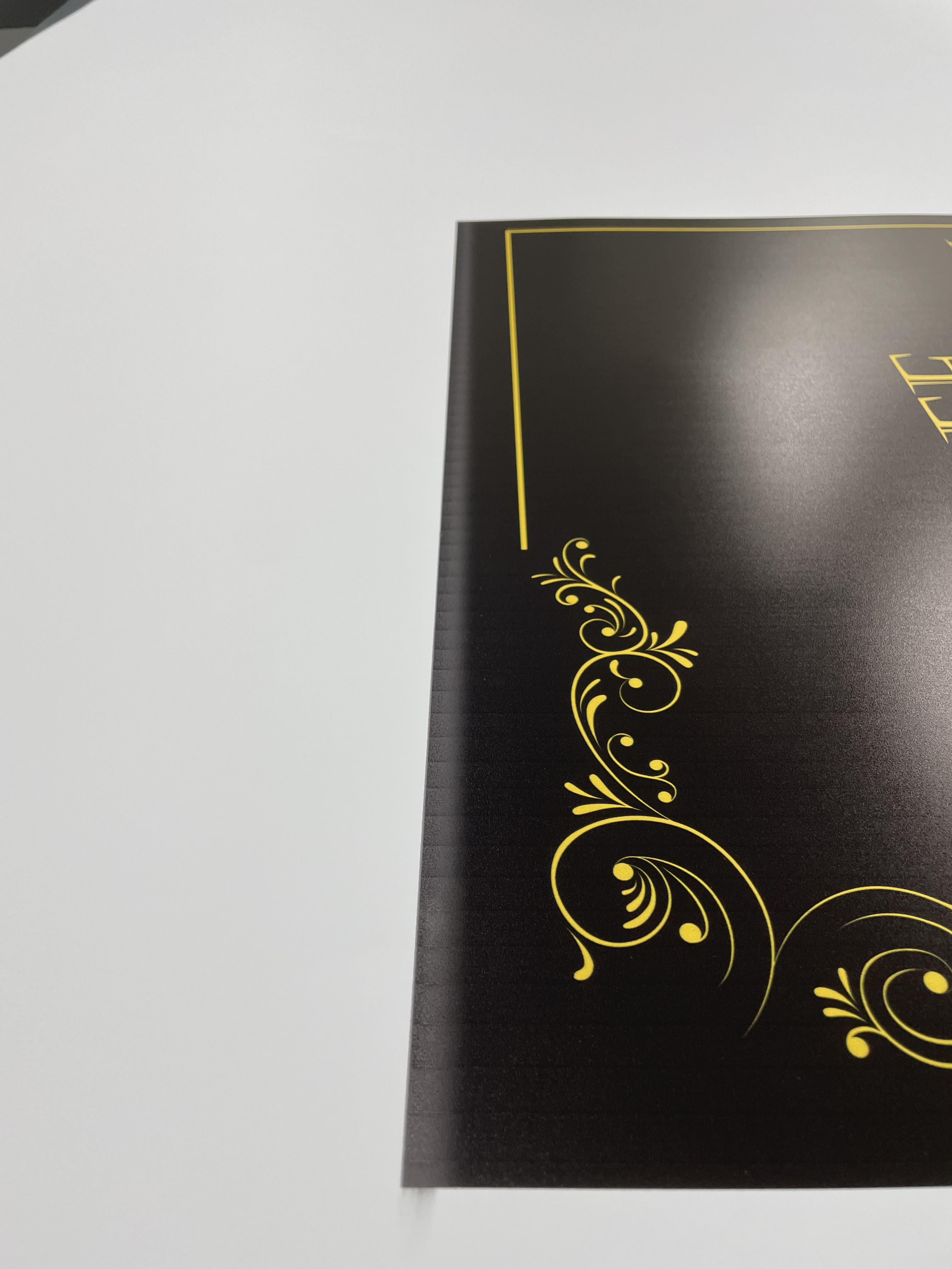

Hi,
A lot of the times when I print full black print one side does not dry, it it always a .5" or so and always on the right side of the bed. Any advice?

We used to have that machine, and I've experienced this problem, but darn if I can remember how we resolved it. Sorry, I know that doesn't help.
It was around the time of the notorious "under performing" bad ink issues with Hp. It may have been that, but it could have been something else, like a calibration issue like greysquirrel suggested.
javagod
Manager
How does your nozzle check look? How does it look when you do a printed color purge in black and then do a nozzle check? I had a situation where my ink, which HP called settled ink It been sitting stagnant for sometime, and the ink settled in the bottom, then thicker ink worked its way to the print head. But on the other hand, it would have nothing to do with that if your ink isn’t dry, that will have all to do with the lamps shutters. I wonder if it’s sticking to begin with, and then loosens up after a few passes
