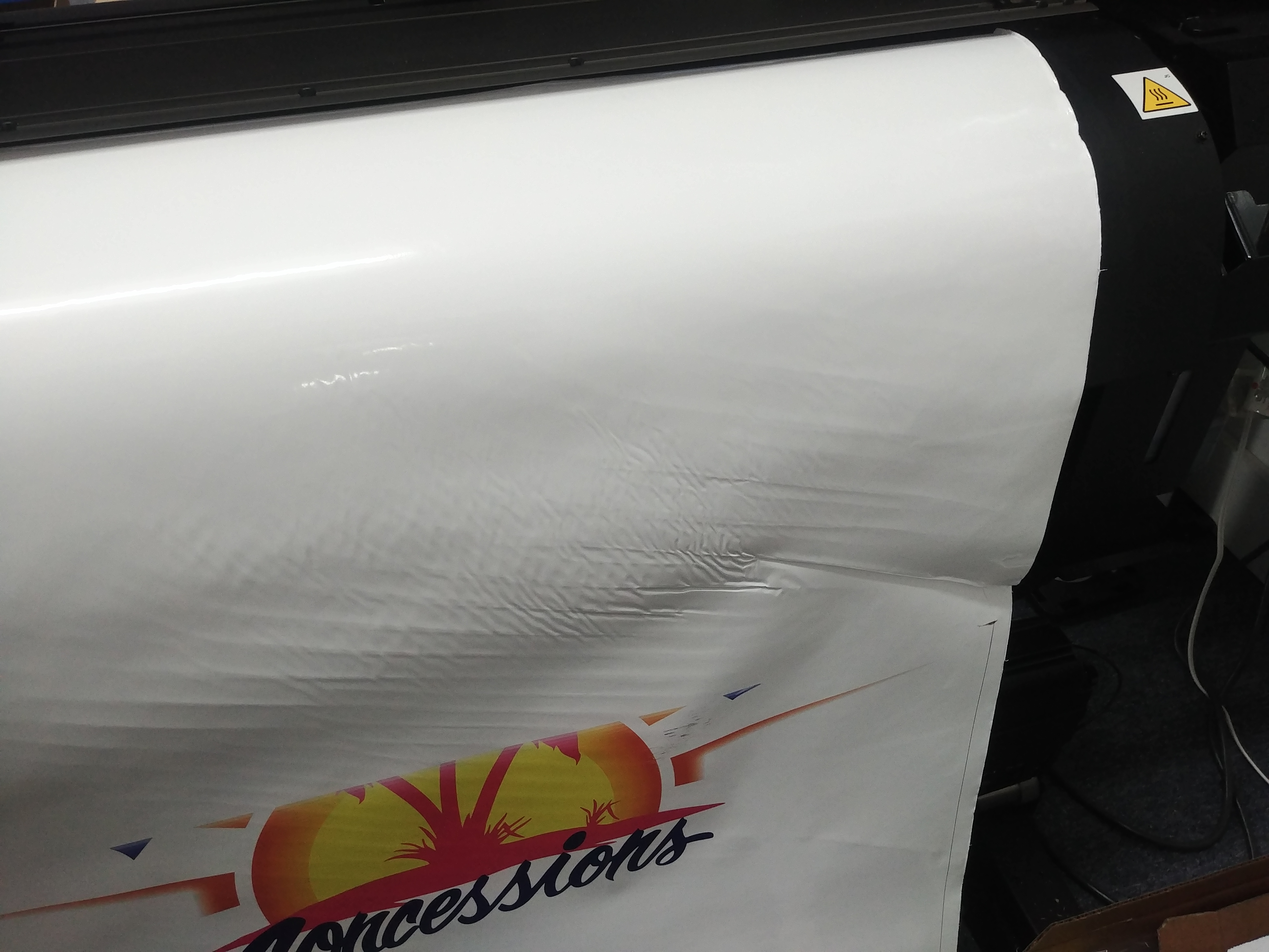

Weve been using oracal 3641 with 210 laminate for years with no shrinkage on concession trailers (it takes the stone chips better for some reason than plain 3M IJ180C w/ 8518 - without any stone guard on top of that. We use 3M on all other wraps) and recently have started to have some of the same issues as OP. Ive been wondering if they changed their formula or something (reminds me of what Avery did).
We have mimaki CJV150 & JV150 both running OEM SS21 inks. We allow 24 hours to gas off before laminating.
The QC has also gotten pretty bad lately too. The last 3ft on at least the past 6 rolls have come wrinkled.

I've ran into this alot lately and I figured out that I was laminating before the vinyl/ink was fully cured. what happens is that the vinyl will cure fine if it's exposed to air, but if you laminate it hinders that for awhile and causes the corners/edges to curl and peel. In some cases it can cause distortion of prints.
let your vinyl sit overnight, then laminate and contour cut. This will let the vinyl relax in it's natural shape and when you laminate it'll stay put. Think of putting tape on a rubber band, if it's under tension it will curl the tape but if the band is relaxed it will stick fine and stay flat.

It's hard to see exactly in your pictures. Is the material there shrinking or is it curling?
My first thought was that you were laminating and contour cutting it too quickly after it was printed. If inks (or the solvents evaporating off) are introduced to the adhesive, it'll degrade. This happens when you run the cut then print function with full bleed decals. The ink gets into the cut and it starts to curl and shrivel. Looking at your picture, what you have there looks laminated.
You said that it was the edges. Is this happening to all of your decals, or is it only happening to stuff with bleed? I'm guessing that its just the ones with bleed. If so, then you know what to look at (ink attacking the adhesive on the edges).
