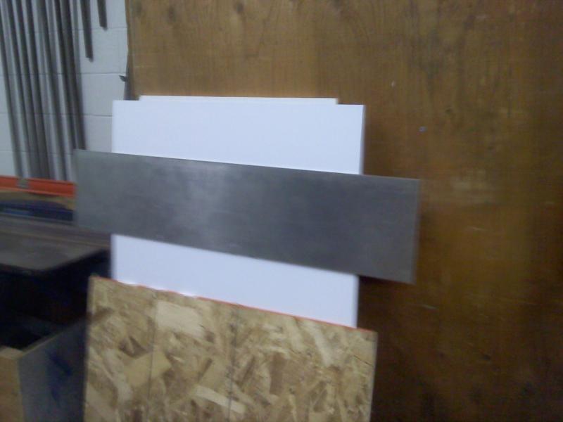

i've stud mouted 1/8" to 1/8" before without having the studs sticking out either side... paired with adhesive of any kind, they'll never fall off.
J Hill Designs
OK approx 5lb - 1/8" aluminum sheet attached to dibond - not only does it not fall off, I am having a hard time releasing it with force
as for exterior, I can only imagine yes since its a PE core with acrylic adhesive...water/solvent resistant
