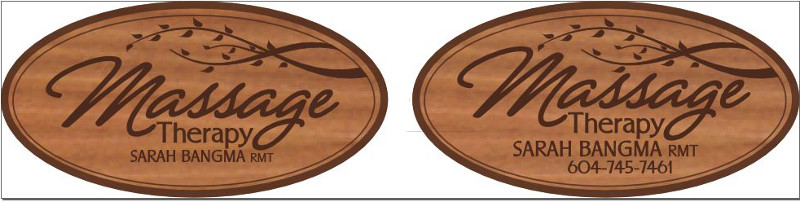

More Revisions
Wow, lot's of interesting discussion happened while I was gone. Finally heard back from my client and she's going with the oval design, so I'm
looking for some more feedback, please.
Sign is going to be sandblasted cedar. My first sign of this type, so any pointers on this will be greatly appreciated.
She really wants a tree, does this one work?
Also, how did I do with adding her phone #?
I want to show her both options imposed on the front of her house to scale so she can see for herself how the extra info doesn't help, but it is ultimately up to her.

I like the one with the phone number but I would center the number to her name.
SignManiac
I prefer the left version without the phone number. Try and improve on the contrast between background and lettering.
What height and what stroke width are those letters ??
Are you blasting the background away or the copy ??
Do you have or know anyone that can blast this kinda sign ??
Are you going to buy a blank and hope the grains match ??
Can you make the proper mask for a sign this size ??
I'm only asking these things, because if you're proposing such a sign, can you really produce it ??
If you're next question is.... who can do this sign for me..... where are you gonna make any money ??
Marlene
without teh phone nubmer. Gino asked a bunch of good questions, how are you making this? you asked for tips about working with cedar so I can only assume you are making it and not having it subbed out to someone who know what they are doing?

Thanks for asking Gino. I am hoping/planning to do this myself (fingers crossed the "tuition fee" aka. screw up factor isn't too high) as I'd really like to add this type of sign to my skill set. I read several tutorials online and the whole process sounds relatively simple, but then it always does when an expert explains it so that's why I really appreciate all the input I'm getting here.
The sign will be 32" wide x 16.25" tall and I am planning to blast away the background. That makes the smallest letters approximately 1" tall with a stroke width of 0.17" Is that too fine/small?
My Father-in-Law has the equipment, I want to try it myself so picked up some extra cedar to practise with before working on the actual sign. My husband would be more than willing to help me with that part (he's a tool a-holic ;) if I can't get it.
I bought cedar and laminated it together to make the blank.
According to it's technical specs my plotter should be able to cut the mask, but I've lost faith in it a while ago (wish I'd found this site before buying it, but it's what I have for now so live and learn I guess) so if it craps out I could try hand cutting the mask but I'd really prefer not to go there as that sounds like a lot more time/work.
At that size for letters and the thinness of them, you’re probably going to blast most of it away from underneath. Even staying at a perfect 90º, you’re bound to blast underneath and annihilate portions.
If you glued it up yourself, did you biscuit or do anything to reinforce your seams ??
Hopefully you used a really good wood glue for exterior use. Remember, after you blast away, the glued areas will be exposed. We use a two-part boat glue. The seams actually seem stronger than the wood itself after drying in clamps for 48 hours.
Good luck !!
