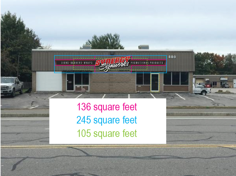

The issue is we are aloud only 105 square feet that idea would end up around 200 square its based on extreme dimensions
change the dimensions so they fit. the one you have doesn't fit the area which doesn't work well on a sigh shop sign as people will notice that
Most towns allow you to measure the individual components of the sign to arrive at your total square footage. Either way, 105 is a lot of area to work with for a building that size, so I'm sure with everyone's help here, you'll come up with something effective.
The setup Neato gave you comes to about 128 sq ft. Just reduce it down until you are close to your codes. Then ask the guy with a bottle of Scotch in your hand, if you can have it a tad larger to fit the building more aesthetically ?? :rolleyes: It could happen................

The way the sign code reads, it looks like they measure the farthest points using only a rectangle, circle or triangle. I scaled out the drawing using the door. Seems like if you want to keep your logo and info, the original design makes sense. Personally, I don't think the sign needs to be everything to everybody, it just needs to identify, but your circle design is strong and recognizable. I'm assuming you are leasing the entire building. If thats the case, use the circle logo over the main entrance door, or use only the logotype as large as you can and use the windows for your other information.
Below is how the area scaled out...
