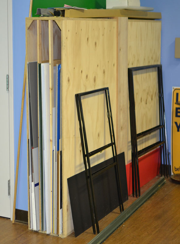

We have a metal storage rack that holds 4x8 sheets vertically. Each "slot" is only a few inches wide so the sheets don't lean very far, to reduce the chances of bending/warping the sheet. As long as our production people are careful, we don't generally have any issues with the sheets getting scratched or damaged.

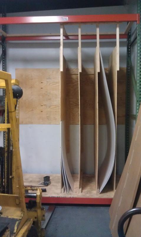

after years of a sloppy unmanageable pile we had a slow day and i sent my guys to the lumber yard. $100 later we have a 120"x60" storage rack with 4 slots.

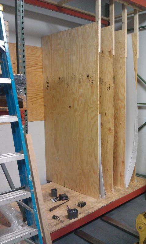

petepaz
going to add some shelves to the left but this is what we have so far

Speedsterbeast
Watching this thread closely. My new shop is almost finished and I'm planning on building a storage rack right away. I like the use of the pallet racking, but the plywood sheets seem like overkill for a divider. Pat, looks like total chaos in your shop, but that's usually a sign of a busy shop.

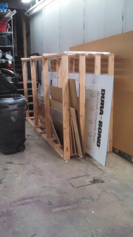

substrate rack
yup. built a frame out of two bys. stuck 1" steel poles front and back 99" tall. six rows of
"i cannot believe that's butter"
rack that takes a beating.

petepaz
all the material used to build the rack we already had in the shop so we are just using it up

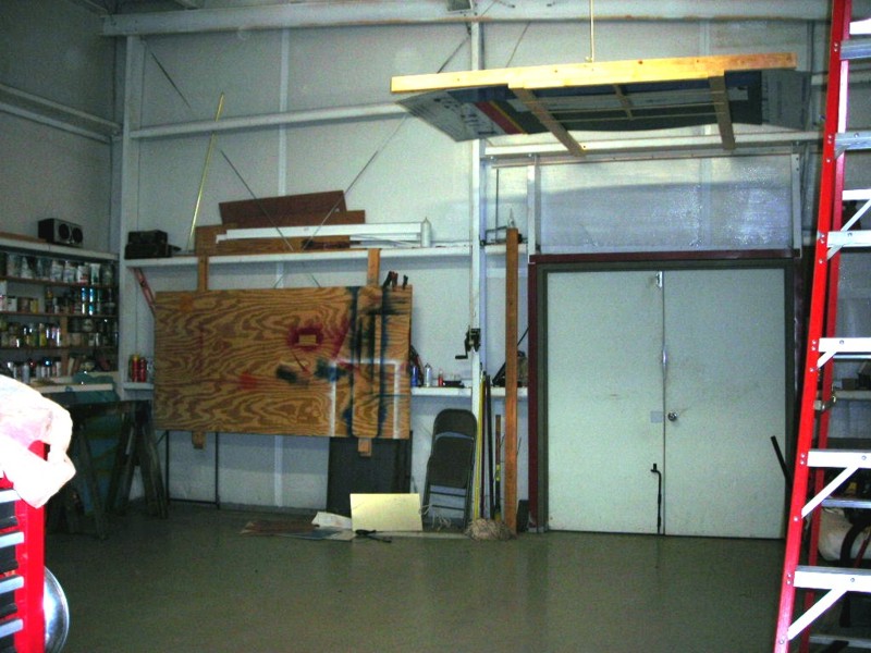

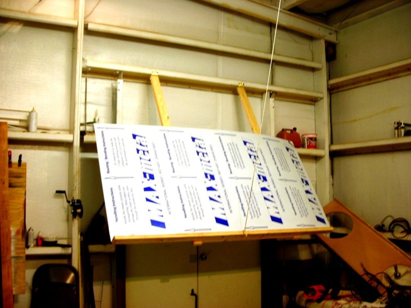

OldPaint
up and outa the way off the floor.
