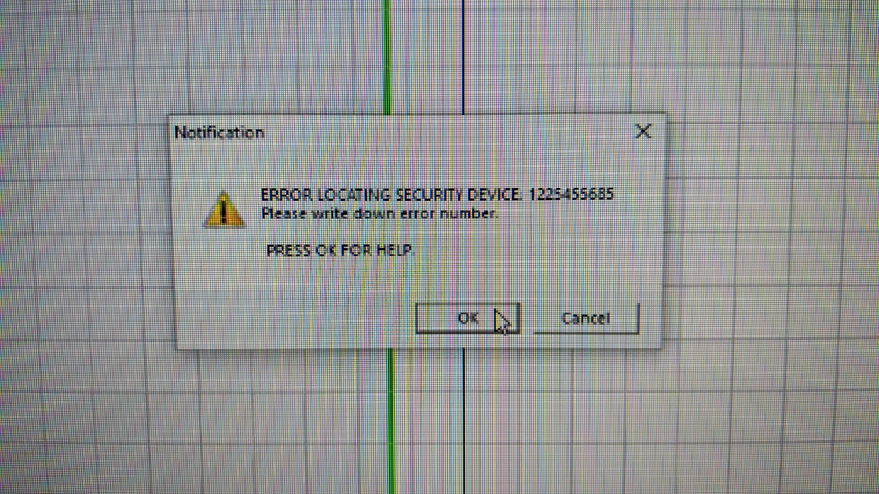

So last night i upgraded to Windows 10. Once everything was finished i checked all my programs to make sure they worked. When i tried to send something to cut in SignLab i get the attached error. I'm assuming its a dongle issue, but im sure how to fix it. Any help would be greatly appreciated.

May have to update the firmware on your dongle. See if there is an update on the driver for your security device for Win 10. That would be the first thing that I would look for.
WildWestDesigns
Well, from what I'm reading, SignLab 9 officially supports XP through Win 7 OSs.
I don't think it's officially supported for Win 10 (which could also go into the fact that there are no driver update).

I reached to Cadlink. In case anyone else has this issue below is their response.
That dongle is very old and is not supported on Windows 10. Here are your options.
1. Just exchange your dongle for a new flash drive type USB dongle - $125 US plus shipping.
2. Upgrade to Signlab 10 Vinyl Pro for $400 US plus shipping - includes the dongle exchange. The upgrade also includes 3 months of free Tech Support which you can extend by a full year for 15 months of coverage for $149 when you upgrade - regular $299. It will also include a free Fluid Mask add on module (value $200).
3. If you are just doing basic vinyl cutting and only running one vinyl plotter you could upgrade to Signlab 10 Cut Pro for $200 plus shipping > includes 3 months Tech Support and dongle exchange.
