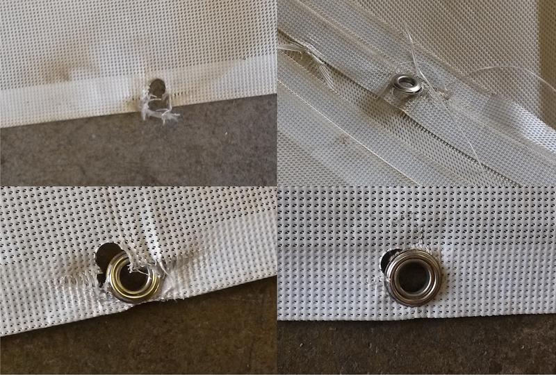

    I ordered a 7' x 40' mesh banner that would be installed on a fence. The area it was going already had the same type of banners installed, it is a large concert venue and this is one of the advertising spots they sell. They have been putting banners up there for 15 years. They are zip tied every two feet and there is never a problem.
    UNTIL i used Signs365...
    I loaded the banner up in my truck along with a dozen other signs that were going up and drove an hour to the place. When it came time for the banner I took it out of the tube and was highly disappointed in the grommets in the banner. They were not crimped all the way, very loose in the holes and some of the holes were double cut, leaving the a hole partly outside the grommet. A definite recipe for disaster. I knew putting it up I was going to be in trouble, but the event was the next day and I was swamped and made the best of it. I took photos and planned on *****ing up a storm to 365. a couple weeks went by and I had to head out to the venue again. I drove by the banner and was glad it was still up. (there were 5 other banner the same size in the same place) I let my guard down *****in to 365 cuz I was busy and didn't take the time to complain.
    A week later I get a call from the venue that the banner blew down...
    All the other banners were fine. I knew it was going to happen, shame on me.
    After talking to 365 extensively they informed me the don't warranty their banners...
    I'm not asking for a warranty, you made a bad product and should compensate me more than the $25 you offered!
    I paid $750 for a banner that was grommeted by someone who had no idea what they were doing.
    fool me once, not again 365!!!

    We have a 10'x50' banner that we never installed because I noticed the grommets were like that as well. Some of them were hanging off the edge of the banner just waiting to rip completely out. And this mesh banner was supposed to go on the side of a building 4 stories up. I nixed the install pretty quick and we went another route but yeah, we've seen the same grommet mess in mesh banners from signs365.

  5. Luckily the artwork of the banner had a lot of white space all around, I was able to tape and fold over the complete edge and re grommet myself.
    I will keep you in mind the next time though, thanks!
    As far as 365 goes, I wasn't looking for all my money back, but something more than $25. At least acknowledgement that their product was not up to the standards that they portray!

    Aside from the lapse in workmanship, could you have used a conical punch to set the grommets tighter?

    Is there not any reinforcement in those hems? It looks to me like this would fail even with perfect grommet placement. Simply taping the edges of a mesh banner is nowhere near enough strength for an outdoor banner.

    A 7X40 Banner, and the grommets ripped out?? Like another said, even perfect placement (without the double punch holes), and that size banner is a recipe for disaster without WEBBING in the hems.
    You're too experienced, not to anticipate problems with a flimsy banner this size.
    It was your cheapest route and you got bit-in-the-***.
    365 is not your "Engineer" or Wind Load experts. They just make what you ask for.
    I would have refunded you $100 tops.
    Granted, that is shoddy work with the grommets (how was their print??), but again..... you needed nylon in the webbing, and 365 doesn't offer that.
    A QUICK TRIP TO LOWES OR HOME DEPOT for one of their hokey grommet kits (to tighten the loose ones, and add more) may have cost you an extra hour.....but saved you a lots of headaches.

  10. I agree, it was my product in the end and my failure.
    I had never ordered a mesh banner from them before and didn't know what to expect. I was hoping for webbing but not sure if it was going to be on there, again, my failure for not looking at the banner before I got out there.
    I expected more and learned my lesson. When I ordered a mesh banner from a reputable company I assumed I would get something that would work.
    Sign101 sure did get their attention, after posting this I got a Credit of $136 posted to my account.
    I think that is fair.
