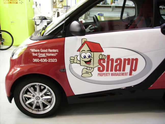

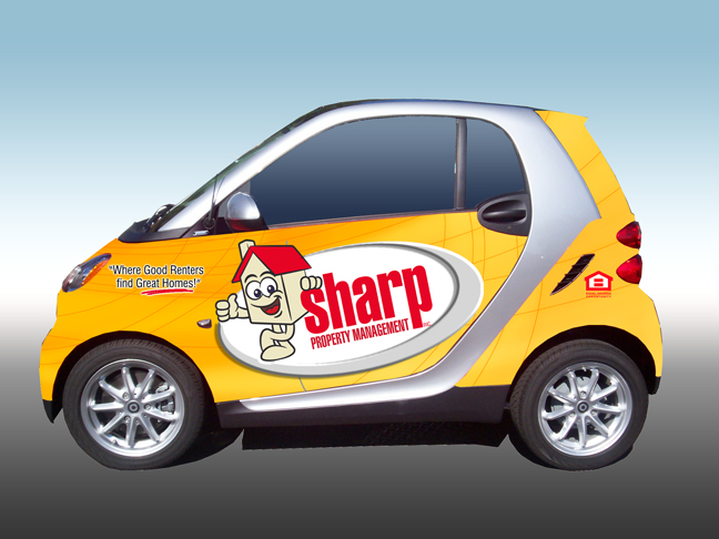

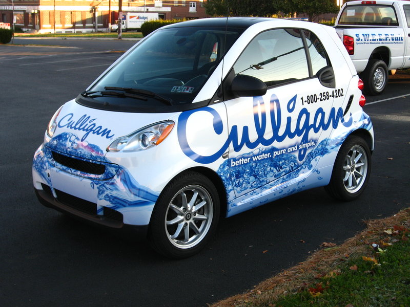

The attached file shows how I proposed a wrap for a company with (2) of these smart cars.
They ended up going for simple lettering, which we printed and cut on our Roland.
Since they bought a red car and a white car, and the door skins are changeable panels, he swapped out the two and we ended up with red and white cars.
I thought they came out okay, but was disappointed we didn't get to wrap these two cars.

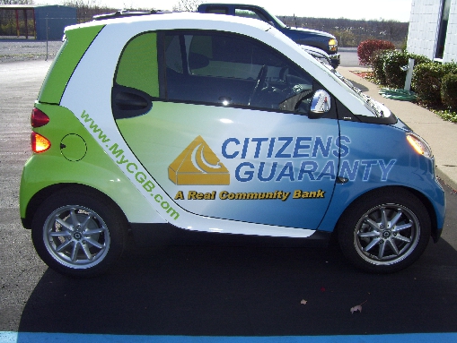

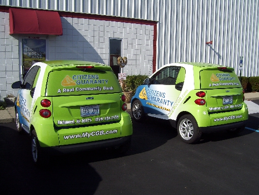

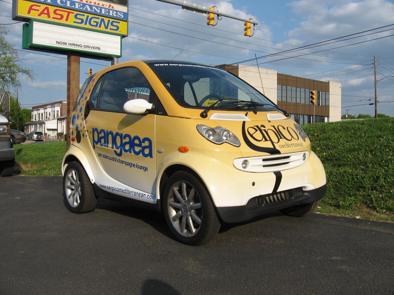

Actually...You certainly CAN use sq.ft. to base pricing on. But the amount per sq.ft. changes per vehicle. These are just sample prices: a box truck or trailer is $8 per sq.ft. printed, laminated & Installed due to simplicity whereas a smart car is $14 per sq.ft. due to compount curves. Though you use less vinyl..the installation time/difficulty is increased. Your shop, your rules. Whatever makes sense to you. Just know your true overhead AS WELL as your true worth (value of your product). I did a fleet of 4 smart cars...in winter. I had to put up small tents in my huge warehouse with torpedo heaters running and spot lights to see. Fenders werent as bad as figuring the best way to do all the dang relief cuts around the tail lights.

Looks like you did a real nice job!
Ok, the smart cars are $14 per sq.ft., what was your total cost per smart car? Because there were four, did you give any kind of volume price break or not?

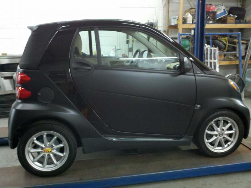

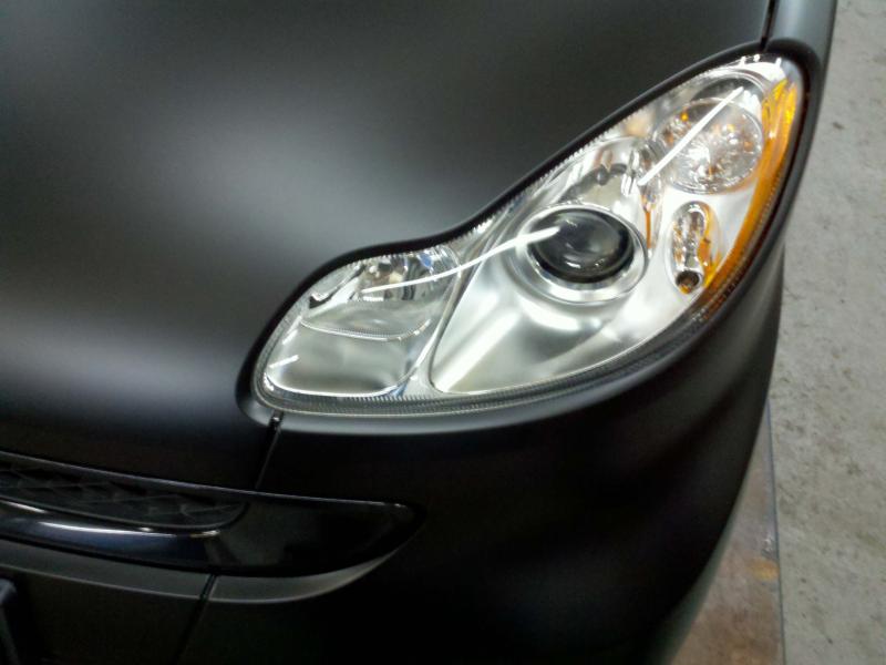

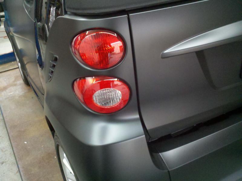

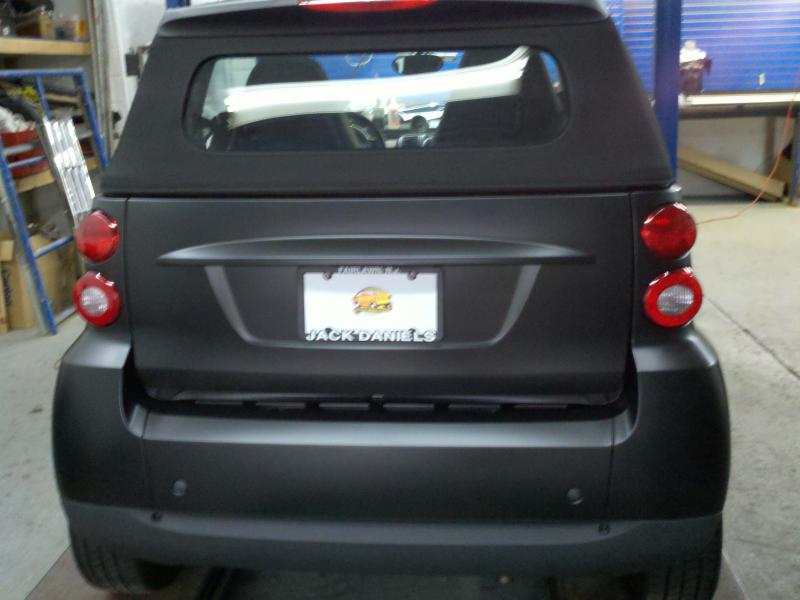

Here's 1 I just did
They're not for everyone but not impossible. Got $32 big ones for this one. Yep, $320. Eat your heart out Mosh. Very Picky customer couldn't find a single flaw.

No prep, cheapest calendared vinyl I had on hand from years ago, no warranty, had kids do the install. It's all about cutting corners these days.
WrapperX
$320? Really? That doesn't seem possible unless you paid those kids like minimum wage. And Calendered Vinyl? Now I AM calling Bull Sh#t! Sorry - wouldn't believe unless I seen it...
MachServTech
Wrapper X you may have to lower your prices. How in the world are you going to compete against cheapvehiclewraps.com ?
WrapperX
MachServ - you may be right - I know I wouldn't be doing it for $320 or a couple of hours on a PS2 :noway:
I just can't compete with that!
