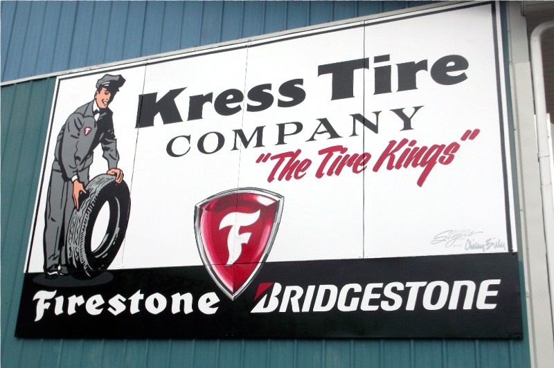

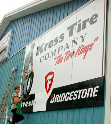

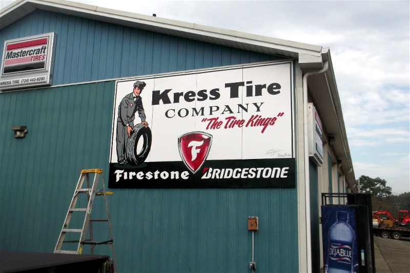

As an example of price, I got $2500 for this job (covering old sign) and it was about 16'x12' with more colors than just black, and this was over 2 years ago.
