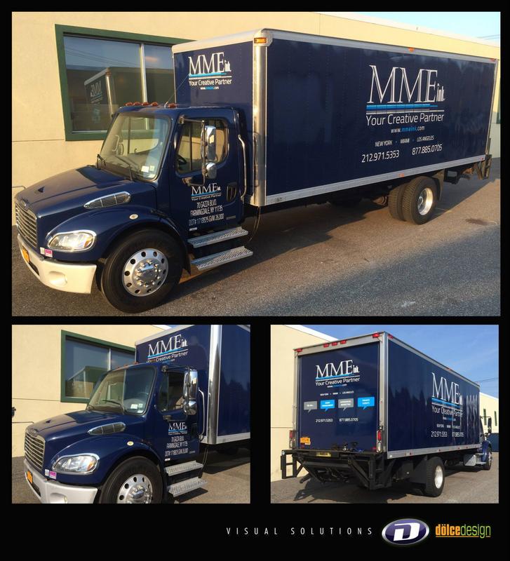

pete... your overthinking it. I attached a photo of a truck we wrapped avery dark indigo blue and did the logo and copy with second level vinyl. If your customer in the end thinks the hinges need to be done. Give them the additional cost mask the suckers get some spray paint ....scuff and spray. if they sell the truck they will have to reverse the hinges. Not a big deal. If it is, they can live with them white. ....Get your deposit and wrap away!!
