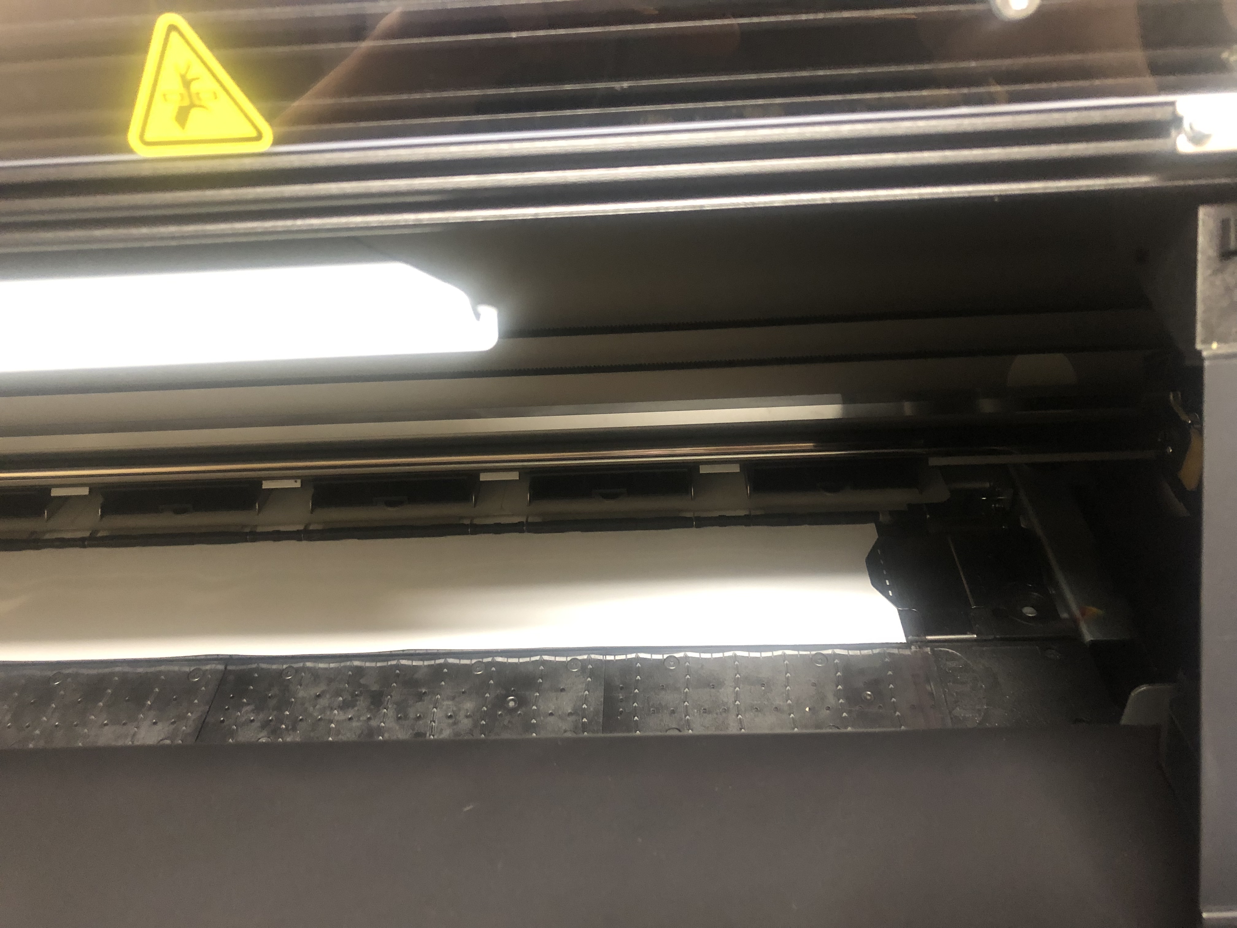

What flappy thing do you use to load? Our printer came with a ton of stuff we don't even use. Never saw a need to use any of it yet... You should be able to load normally. I think the accessories like the loader assist is for stuff like cloth or material that curls. I'm not at work right now so I can only get pictures of.my 110. But this is where my 110 and 560 load to... Right below the cutter Channel. This is also where I print on good car wrap materials - everything else I extend to go past the heater.
